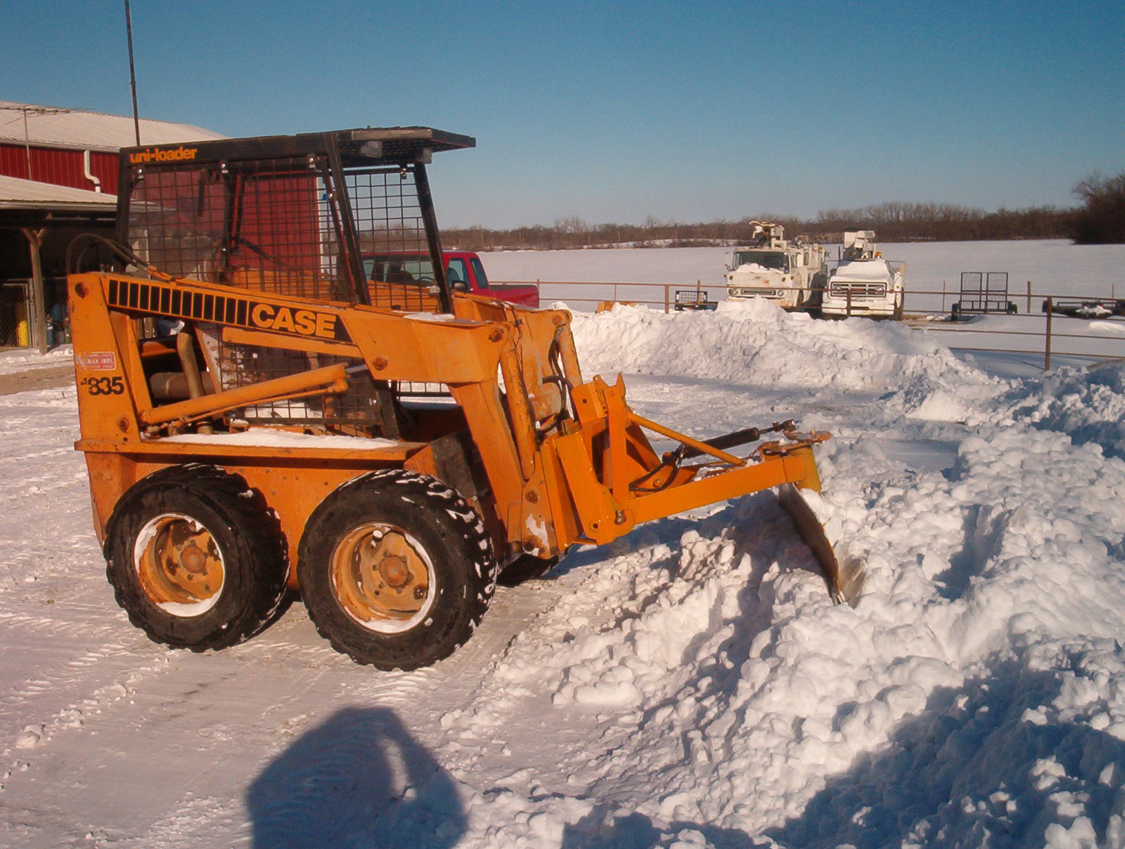

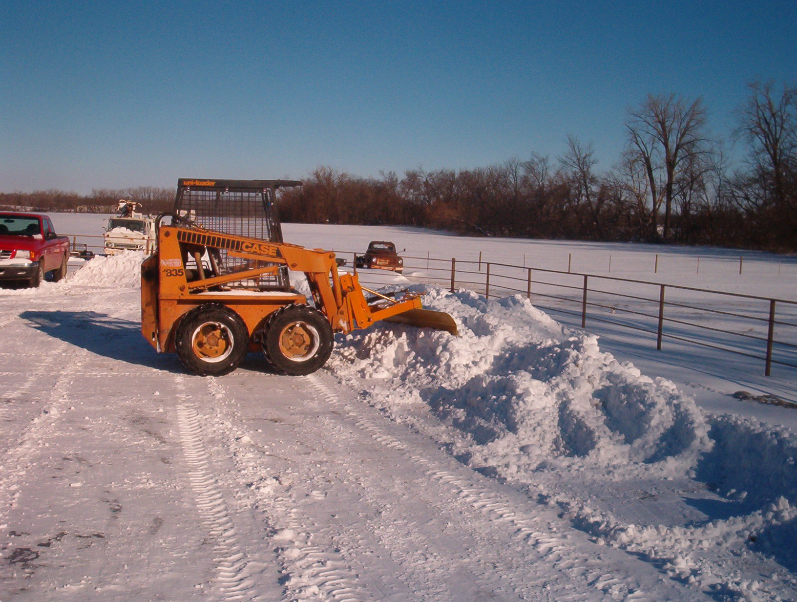

Heres couple of pics of my rear mount blade on the front of my 1835 case.I mounted A TPH QA on the skid steer QT.Works great for pushin snow.I push with the back side of the blade so it doesn't dig the gravel.

Forgot the pics.

Nice SET UP!
With the hydraulic power-angle on the blade it has a lot of possibilities for dirt work, as well as snow.
I assume you flip the blade around, facing fwd, and push the snow with it?

I push snow with the blade the way you see it.It doesn't dig into the gravel that way.
Mrjimmi, I can unbolt 2 bolts and rotate the blade 180 and put em back in about 3 minutes. The cylinder is A steering cylinder off of A case combine.
