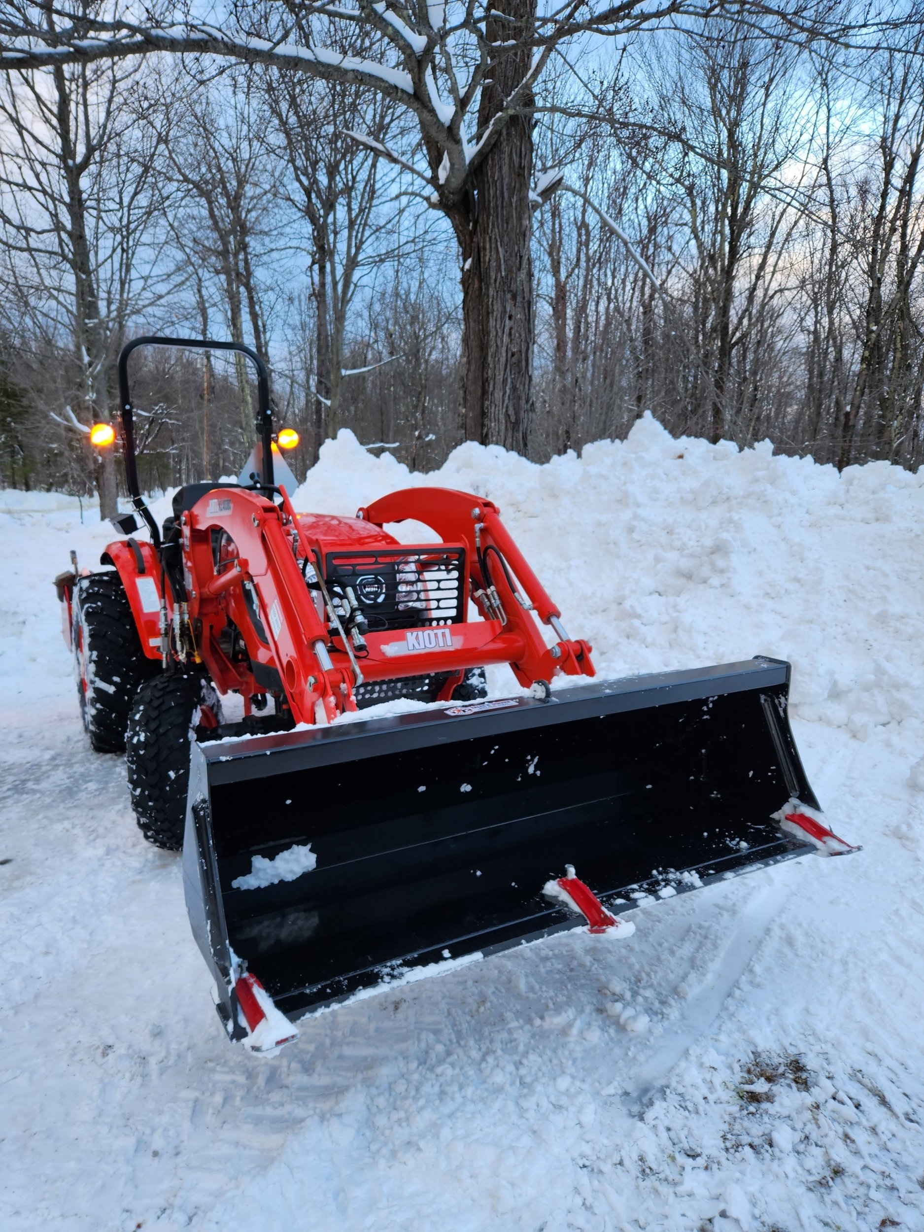

This is something you can indeed do; if it's new to you I would suggest a solid set of Edge Tamers to help you out.

The Edge Tamers that tacticalturnip recommends are great for bucket work in general. I have a set that I use for snow removal on gravel, mulch, and dirt work.
I also use a regular plow blade and pusher on the fel for the majority of my snow plow work on anywhere from 15-20 long rural driveways. I have never damaged anything.
   / Pushing snow with the bucket of my 790 #5
Using the Edge Tamer allows the use of float when moving snow; without them I find I need to keep and constantly monitor the down pressure.
Or that's been my experiences. I'm really happy with them, and have had the Tamers over two separate tractors; if I were purchasing them again I would get the new ones that bolt into cutting edge holes. Provided you have them.

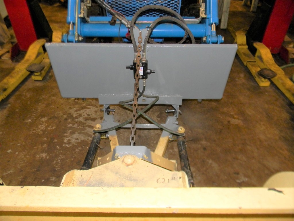

Pushing snow with the bucket of my 790. I bought my 2000 790 from my ailing friend. Have known this meticuliously maintained machine since he bought it. Have heard that pushing snow with a plow attached to the loader arms will blow out bushings due to angling the plow.
Is the plow angling function manual (such as manually moving a pin) or is it angled by hydraulics?
Perhaps you are using the curl function to angle the blade. If hydraulic you can install a cushion valve which will allow the blade to turn if a solid object is hit. I have one on my tractors quick attach truck plow. Haven't used my plow yet due to light snowfall this winter, just been plowing with the bucket so far. Attached is a pic of my cushion valve.
