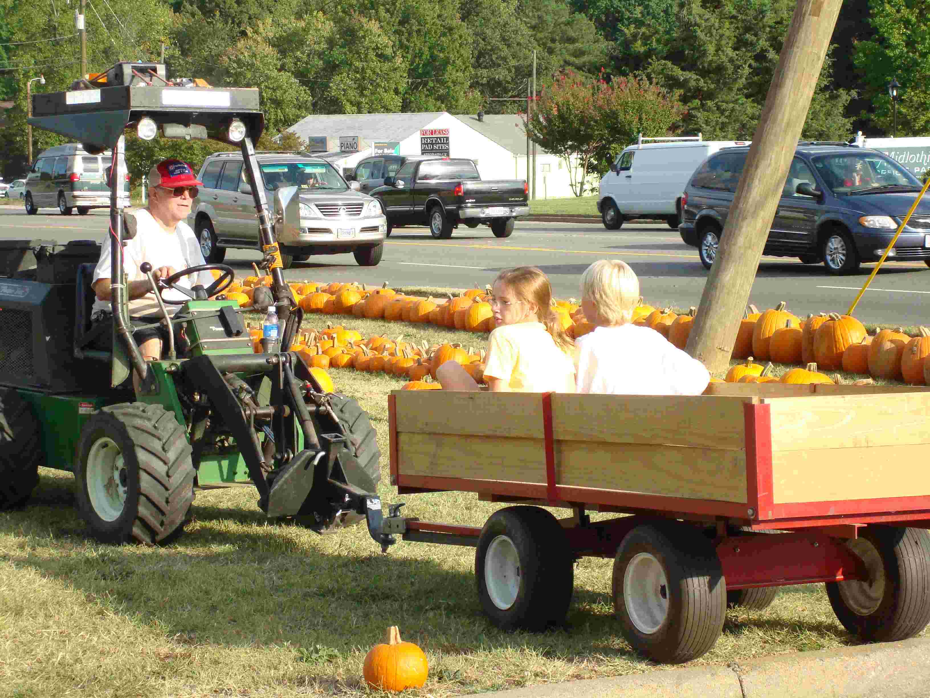

Reg, in 4 hours of use (and I was dead tired near the end with about 25 trips) I did jackknife the small trailer (3 X 6 feet)once. No harm was done and it was a very busy parking lot with a lot of distractions.
http://www.tractorbynet.com/forums/power-trac/45751-works-parade-too.html?highlight=works+parade
