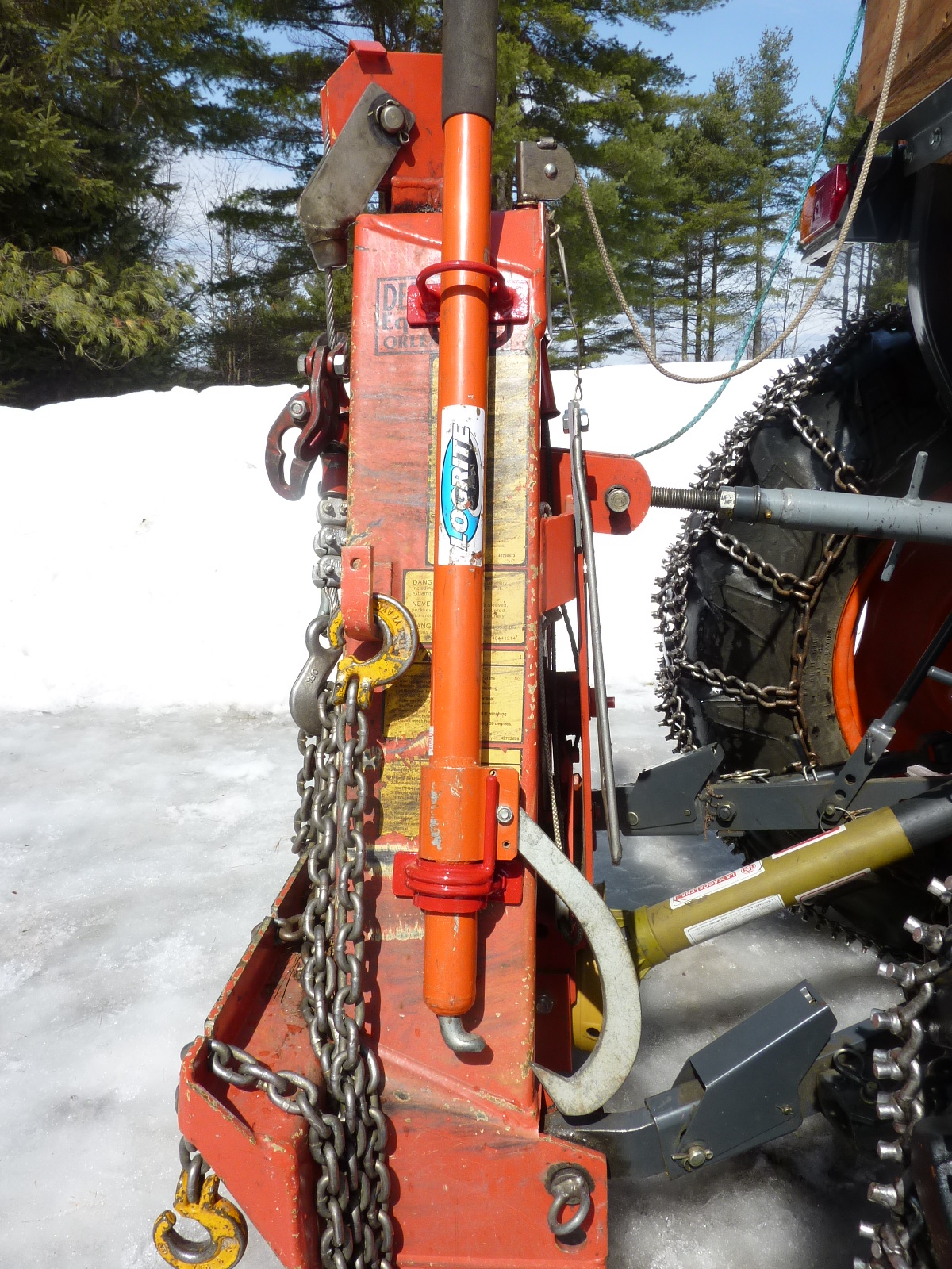

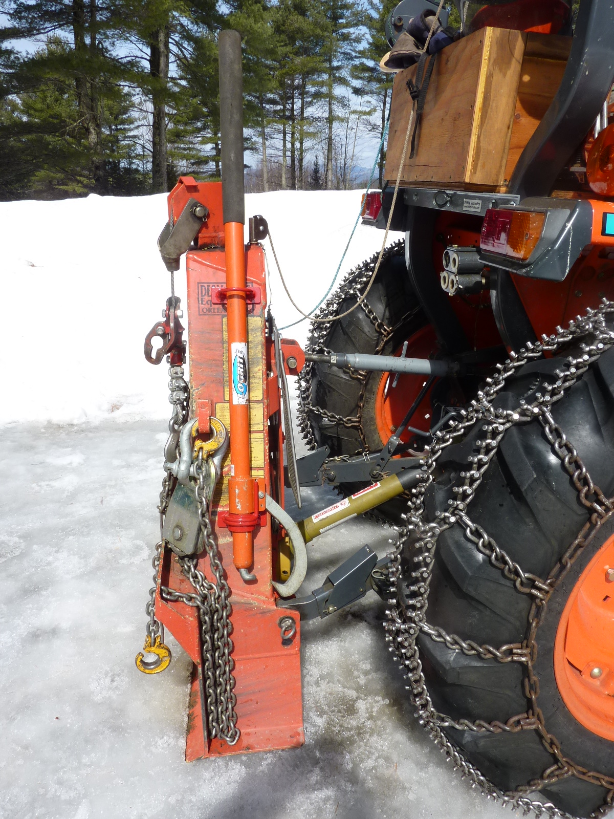

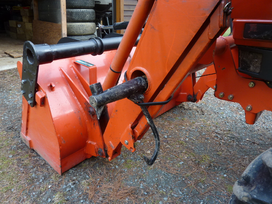

I ued to carry my Cant Hook Like this
It worked pretty good but wasn't that handy to get at some times in tight woods or when the tractor was in the barn against the wall. I was also afraid I would catch the hook on something. So yesterday while it was raining I made some brackets.
I mounted them on the side of winch today. I think I will like this arrangement better.

Nice job Gordon , that looks handy, may need to look into making something like that !
   / Put a Cant Hook ( Peavey ) Hanger on My Winch #4
Nice work. It's making those little personal modifications or improvements that I find very satisfying. If you're anything like me, every time you pull that peavy back there where you need it, it'll make you happy.
   / Put a Cant Hook ( Peavey ) Hanger on My Winch #5
Nicely done!
I especially like how hanging that peavey from your fancy custom brackets turned it from a beat up old wooden handled model to a fancy orange metal or fiberglass handled model.
Very kewl!
Nicely done!
Very kewl!
:laughing: If I said I wore the old one out it would give you an idea how long it takes me to make changes for the better around here - just ask my very patient wife.

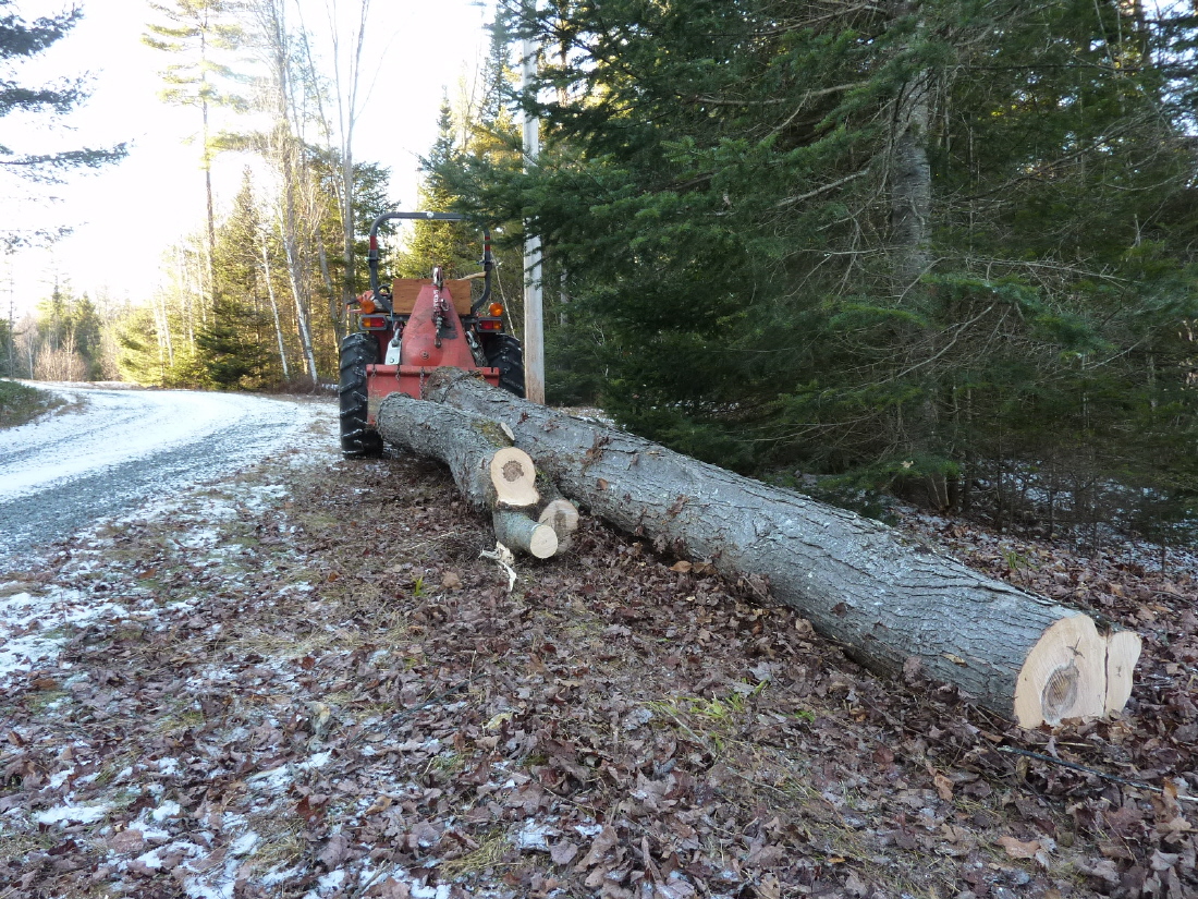

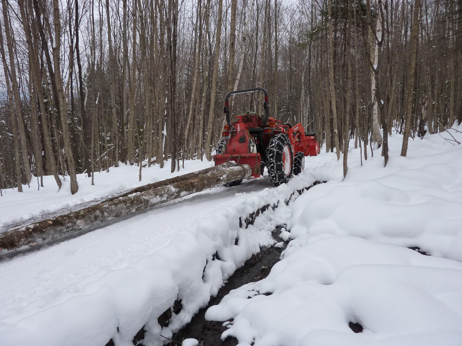

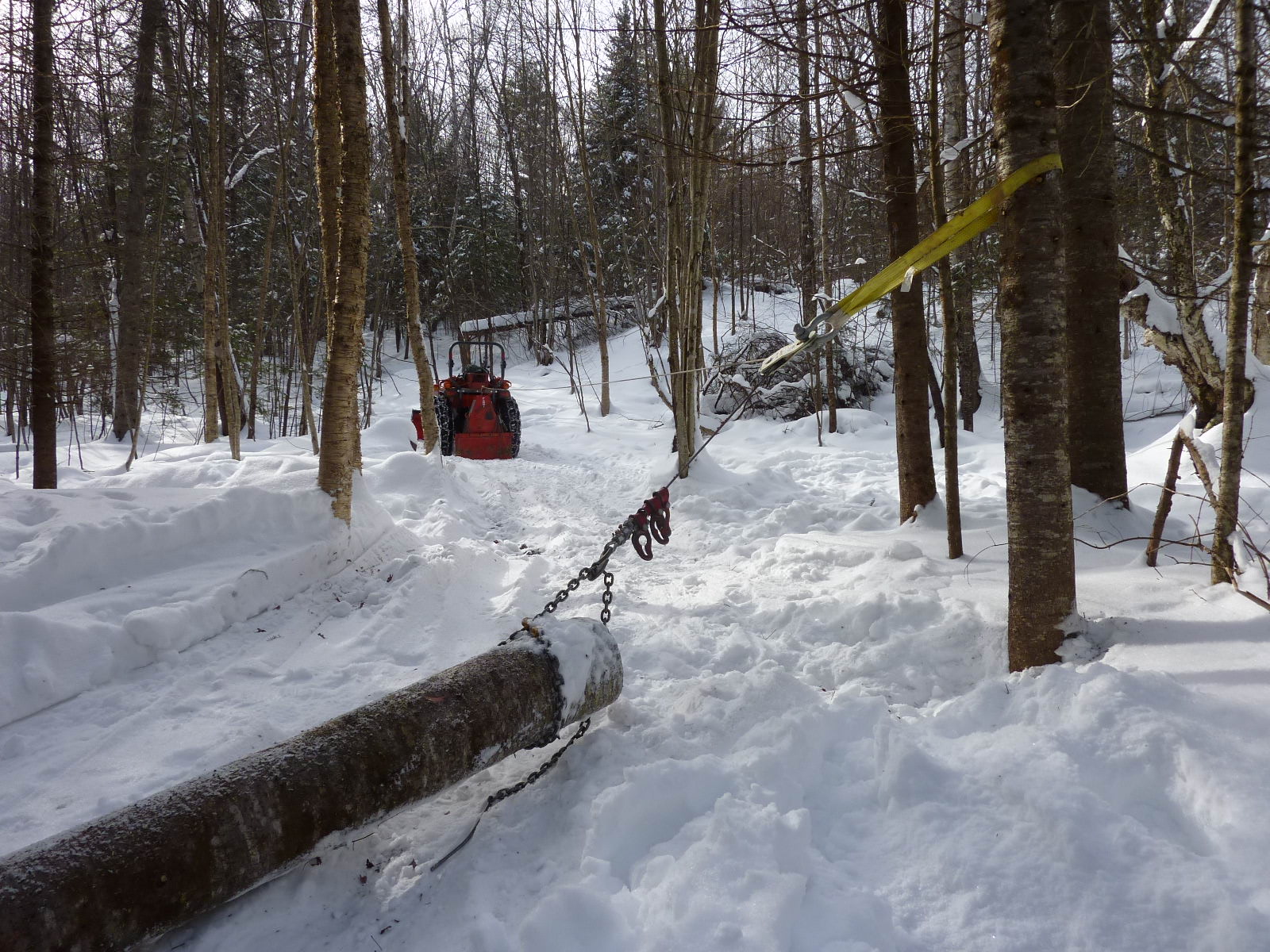

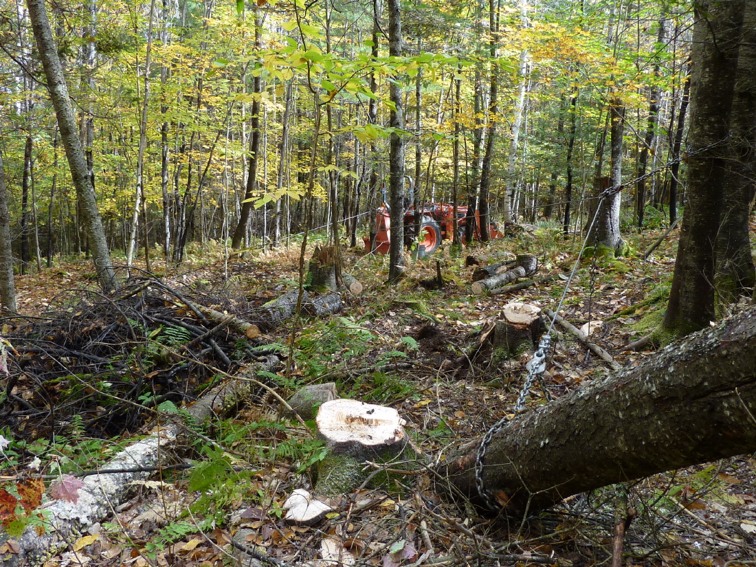

They are very handy especially if you work in the woods. It is pto driven. They are called logging or forestry winches. They have various sizes depending on tractor size. Pulls are from around 5000 lbs to 12,000 lbs. There are many brands - Farmi, Fransgard, Norse, Wallenstien, to name a few. Mine is a small Farmi at 6400 lbs on a 30 hp tractor but it will do a lot.
The two main purposes are (1)winching in logs or trees from the woods to the tractor and then (2) lifting one end of the hitch of logs and skidding them out of the woods to a landing. But, you can do lots of other things too. You can get a lot more pull from a winch than you can from your draw bar and tires. They are expensive now. When I bought mine they it was only $1500.
Here are a few photos.
EDIT: And a not to good video of pulling a twitch of small trees out and around the corner onto the skid trail.
http://youtu.be/yosJrGCZo8o
