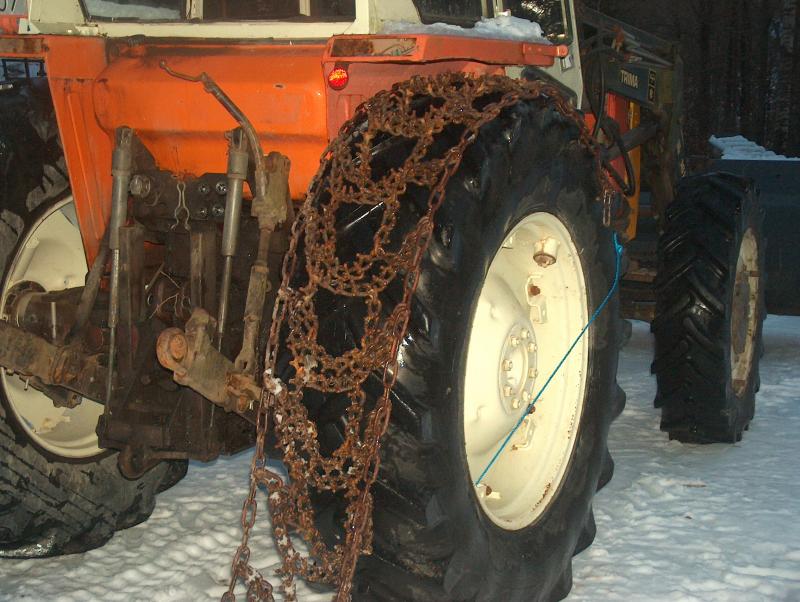

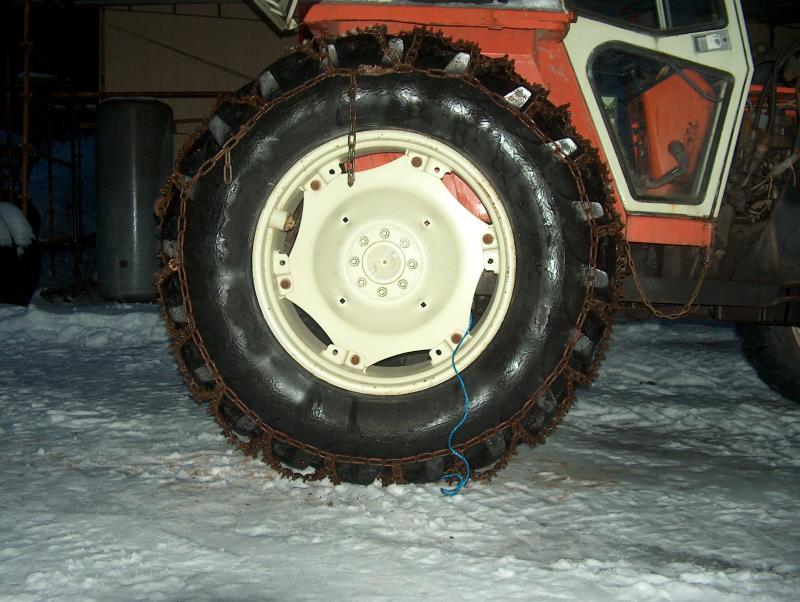

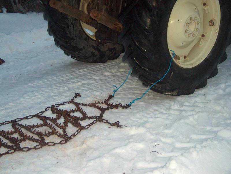

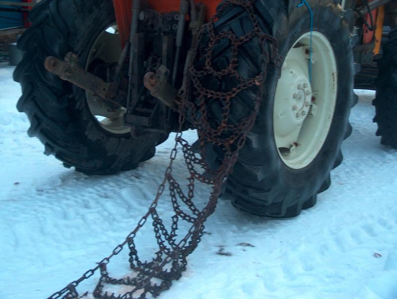

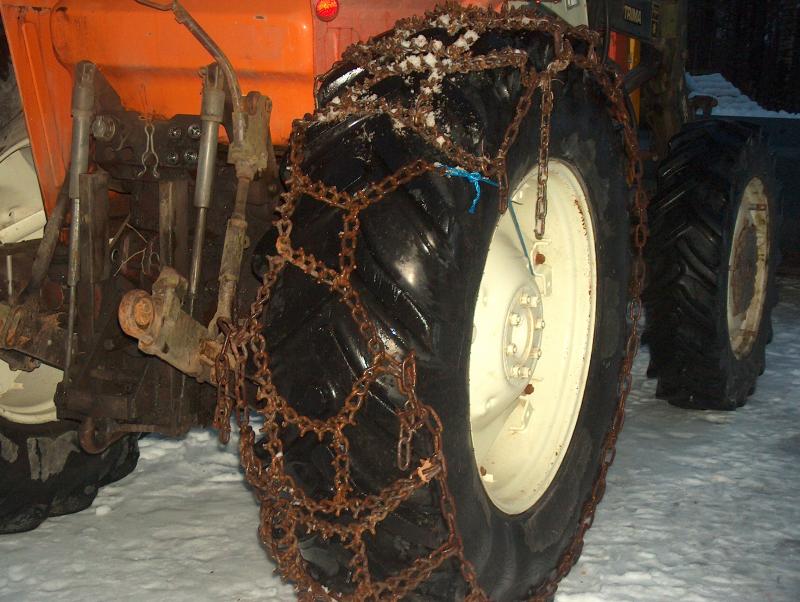

This is the way I do it, works fine for me! No lifting
1.Spread the chains on the ground behind the tractor, spikes up!
2.Tie a rope through the wheel and to the ends of the chain. (not the sidechains)
3.Start driving slowly forwards
4.Stop and pull down and adjust the side chains sometimes
5.After a complete round, stop and hook the sidechains together
6.Then the center chains
7.Nice and tight
Take a final tightening after a good test run, if needed

   / Putting chains on #2
I guess it takes a real Scandahoovian to come up with an idea like that.
That's one of those "why didn't I think of that?" ideas. I can't wait to go out and try it.
Takk skal du ha. :D
(Suomi) Knute
   / Putting chains on #3
Far Out!!!! I gotta try this.
   / Putting chains on #5
Mornin Gunnar,
Very good idea ! Just think, if you had one more piece of blue wire you could do both chains at the same time ;) :)

I use the same basic approach with a minor variation. I tie a rope to the chains the same way but then pull the chains part way over the tire and pull the rope forward and loop over the tread. You can then drive forward and the rope will stay in place. For in garage attachment, I jack the rear end off the ground, use the same rope attachment and then rotate the wheel by hand. This makes for easier chain centering and tightening with the wheels off the ground.
This was the recommended attachment procedure for my made in Norway chains.

Gunnar,
This year is my first year putting chains on my JD 2010. I did it the same way you did except I used the red load tie down straps. It took me less than 3 minutes to do each tire. I put a bunch of bungee straps across the wheel to snug the chains a little. From what I have read, the chains are much tighter this way and have a lot less movement when driving on them. I found the method around a month ago on TBN. Great idea and a lot of folks will appreciate your posting the idea.
