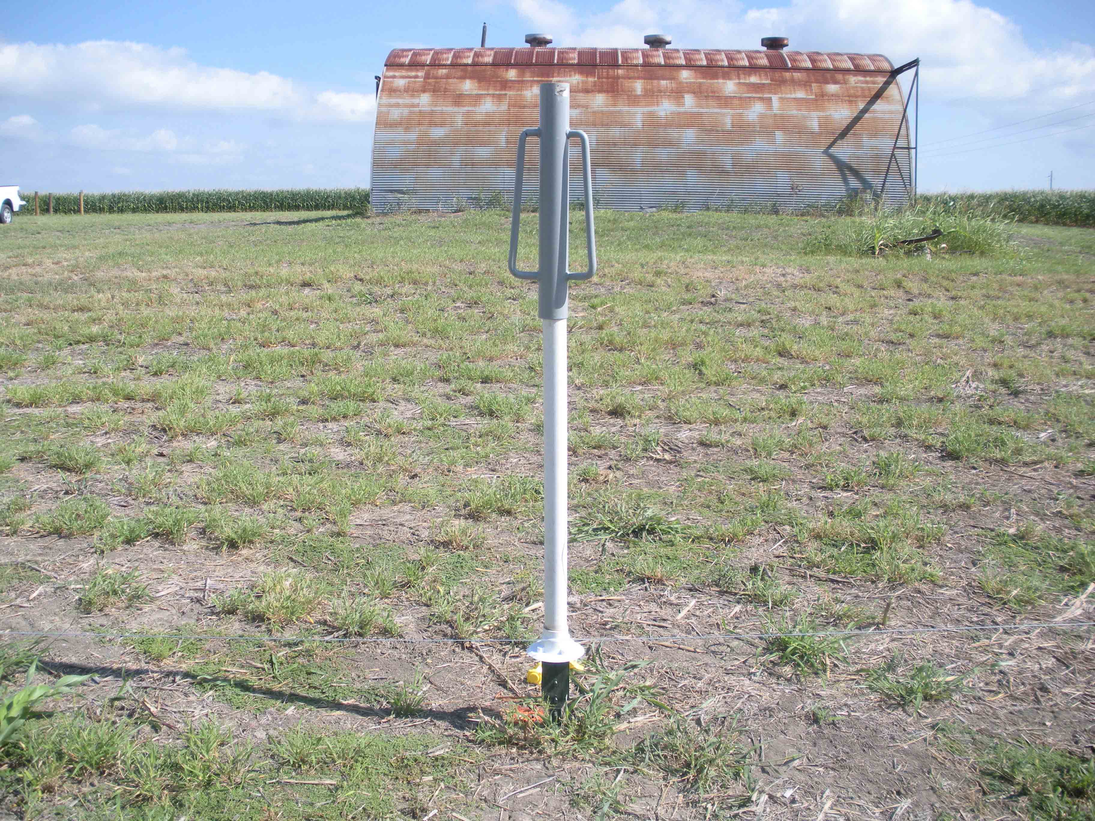

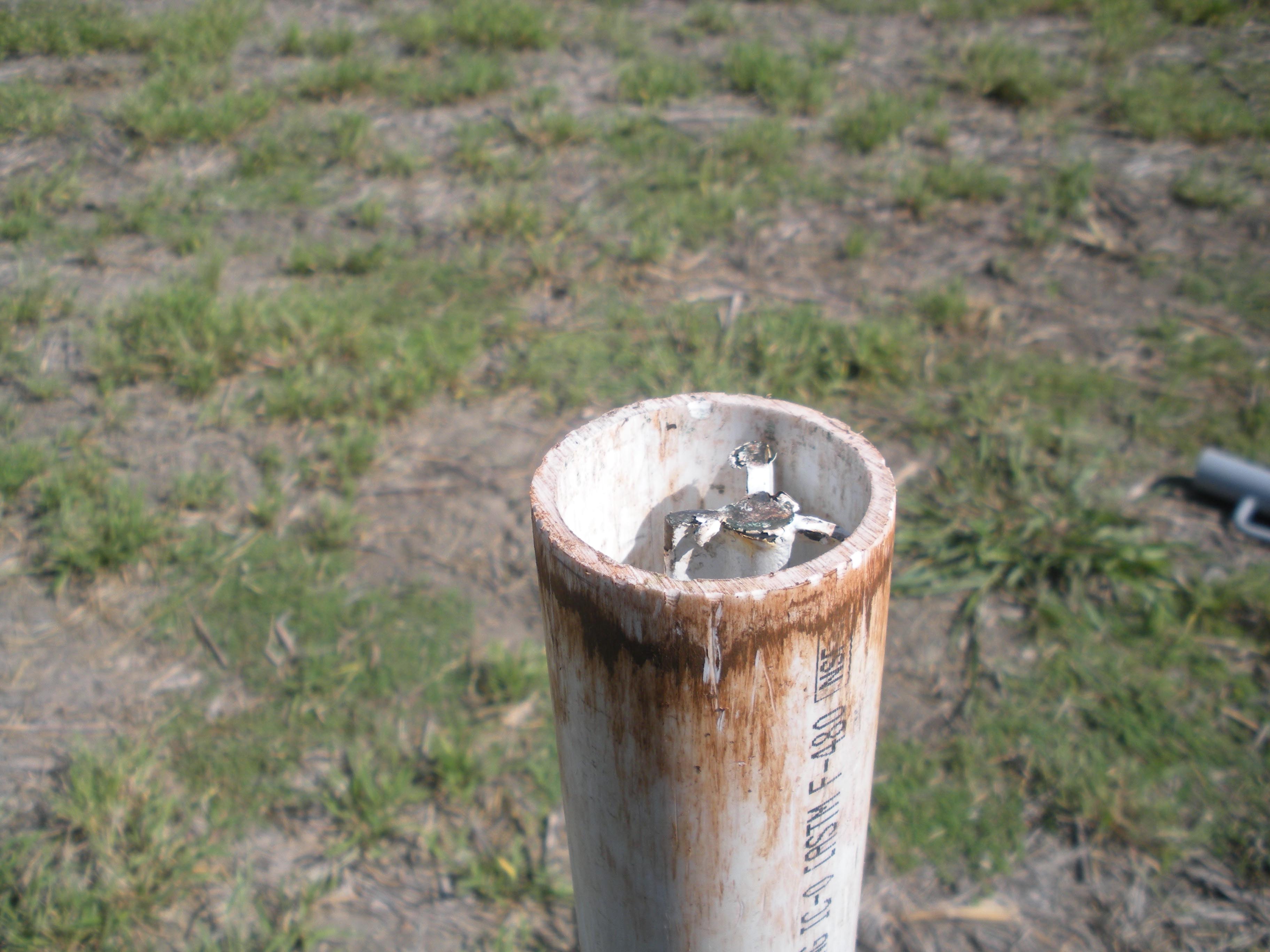

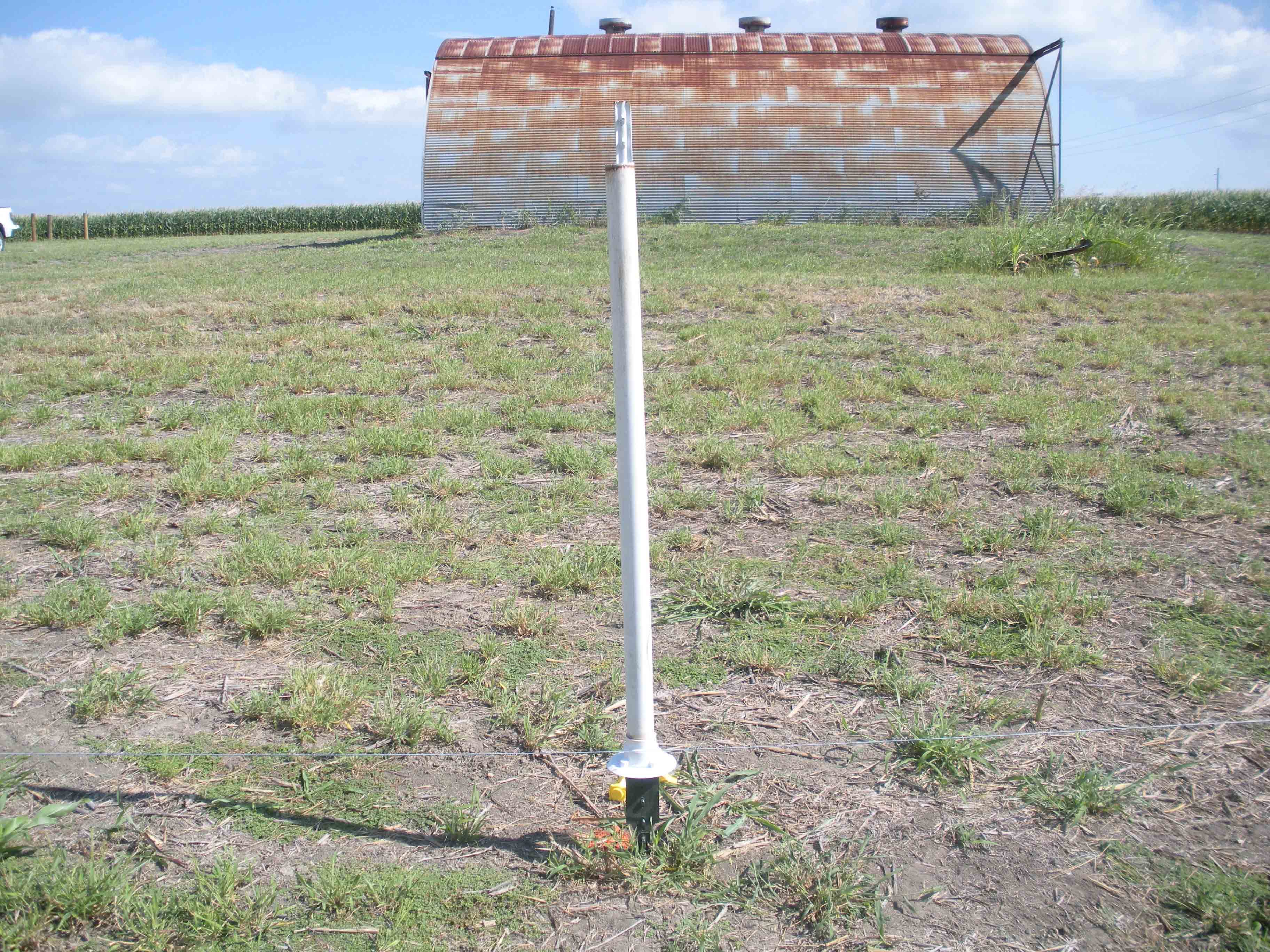

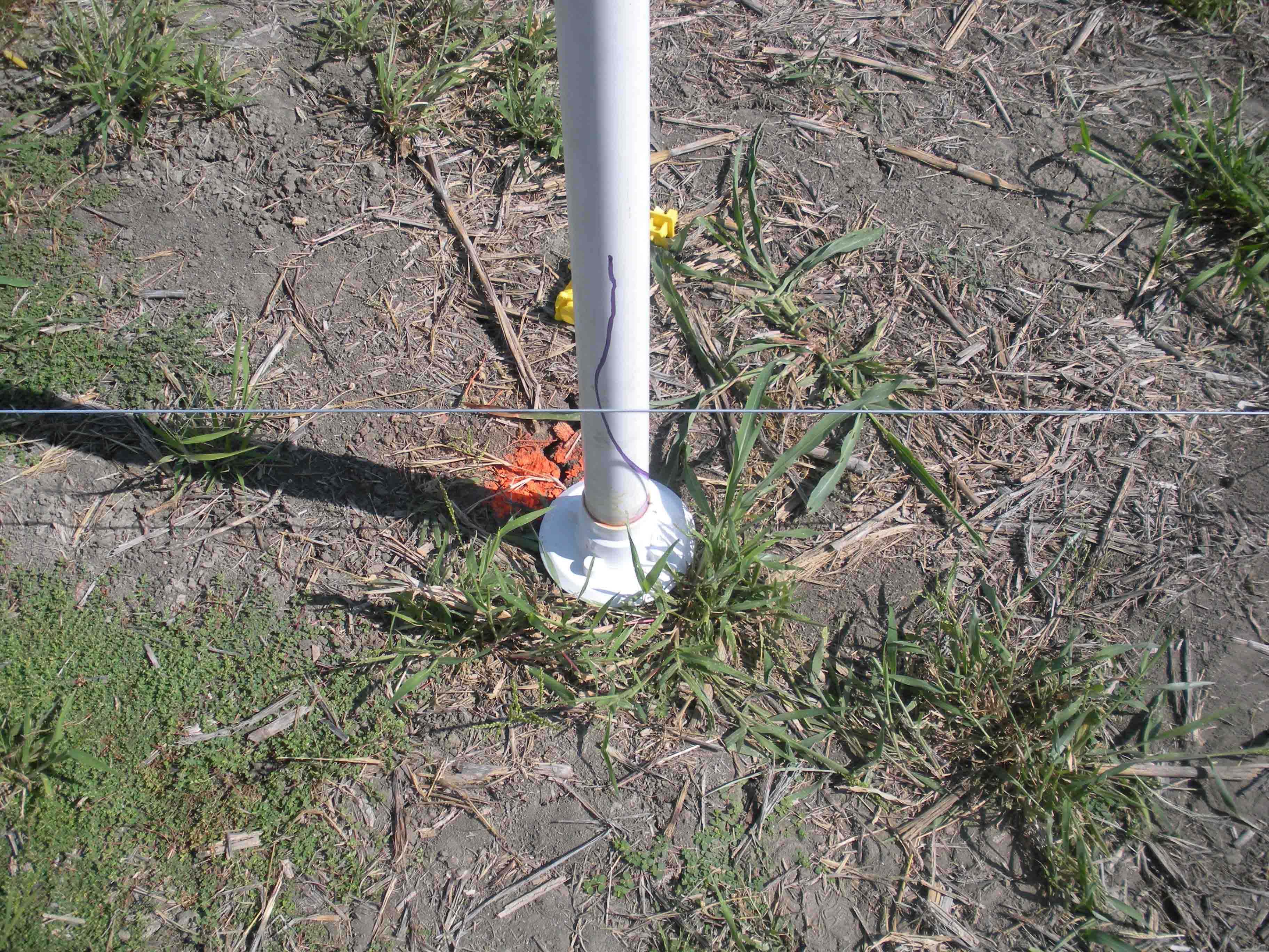

I took a PVC pool drain and some 3 " pipe, measured how high I wanted the T-Post and assembled.
It will work with the FEL or a TSC manual T Post driver.
I pounded 10 posts by hand(not fun) and did another 27 with the tractor and FEL, no helper, using this gizmo and it worked great. All the posts down the row were very close in height with only a half inch or less variation.
Cost was $13 and 15 minutes to put it together.
