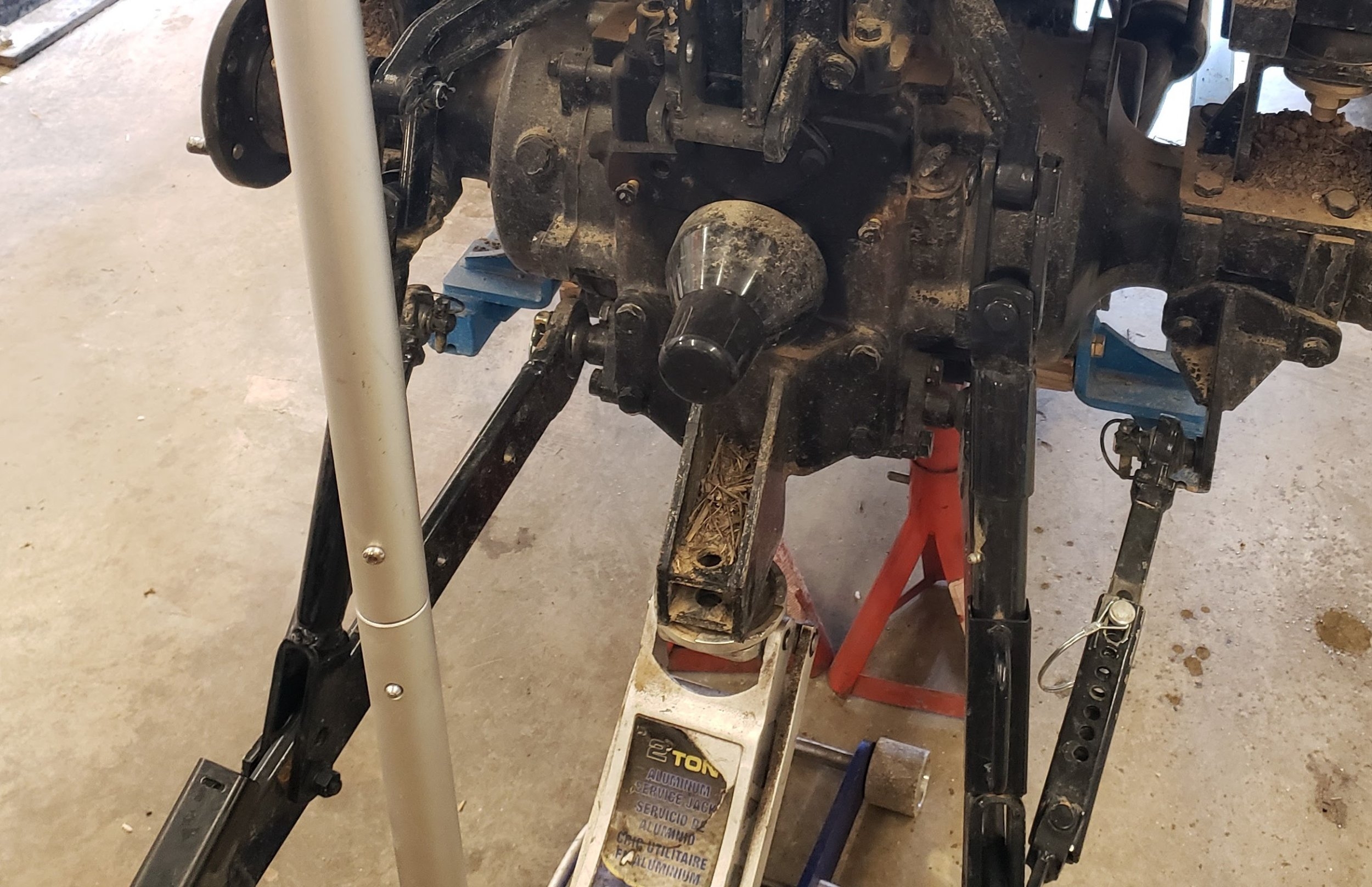

I want to remove one of the rear tires and was wondering if it is OK to put a jack stand under the rear axle housing. No room to get it directly under the axle and the strut that goes to the loader is too close to the rear tire to get the jack stand in just under where it is bolted to the rear axle housing. Here's a pic of where I was planning on putting the jack stand.

I think you will be fine there.
   / Putting jack stands under the rear of a MT3 tractor #3
Ya, you're good. Just make sure the tractor doesnt tip.

Looks good to me, I went right under my loader sub frame.

I pick my M's up using the drawbar attachment plate. That centers it pretty nice. Takes a 10 ton jack however.

When I was installing my subframe mount, I took both tires off for better access. I didn't use the jack stands on the axle as I needed to work on those specifically. So I used the floor jack on the drawbar and placed the stands under the transaxle housing. It was stable. For other times, I simply put them on the axle as close to the tires as possible. No issues.
