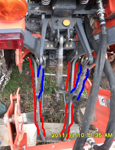

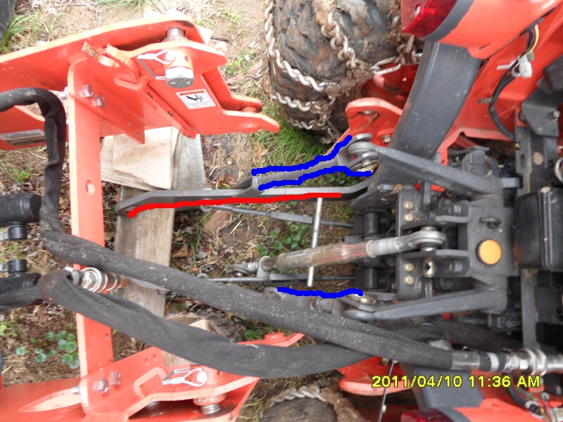

I've a Kubota B7610 and a Woods BH70X (lovely combo).
Mounting instructions require removing all of the 3pt components, top link, lifting arms, etc.
I've been doing this, but removing the lift arms and telescopic stabilizer bars is a pain.
Today I just had to raise the BH to hook up the hydraulics. It looked like if I just disconnected the lift arm leveling assembly brackets (or whatever they are called, outlined in blue) I could swing the rest together and there would be plenty of room for it all to fit. I'm not sure about the vertical clearance but it looked like they might not get in the way.
Has anyone does this?
If all I had to do was pull two pins it would be a lot easier.
