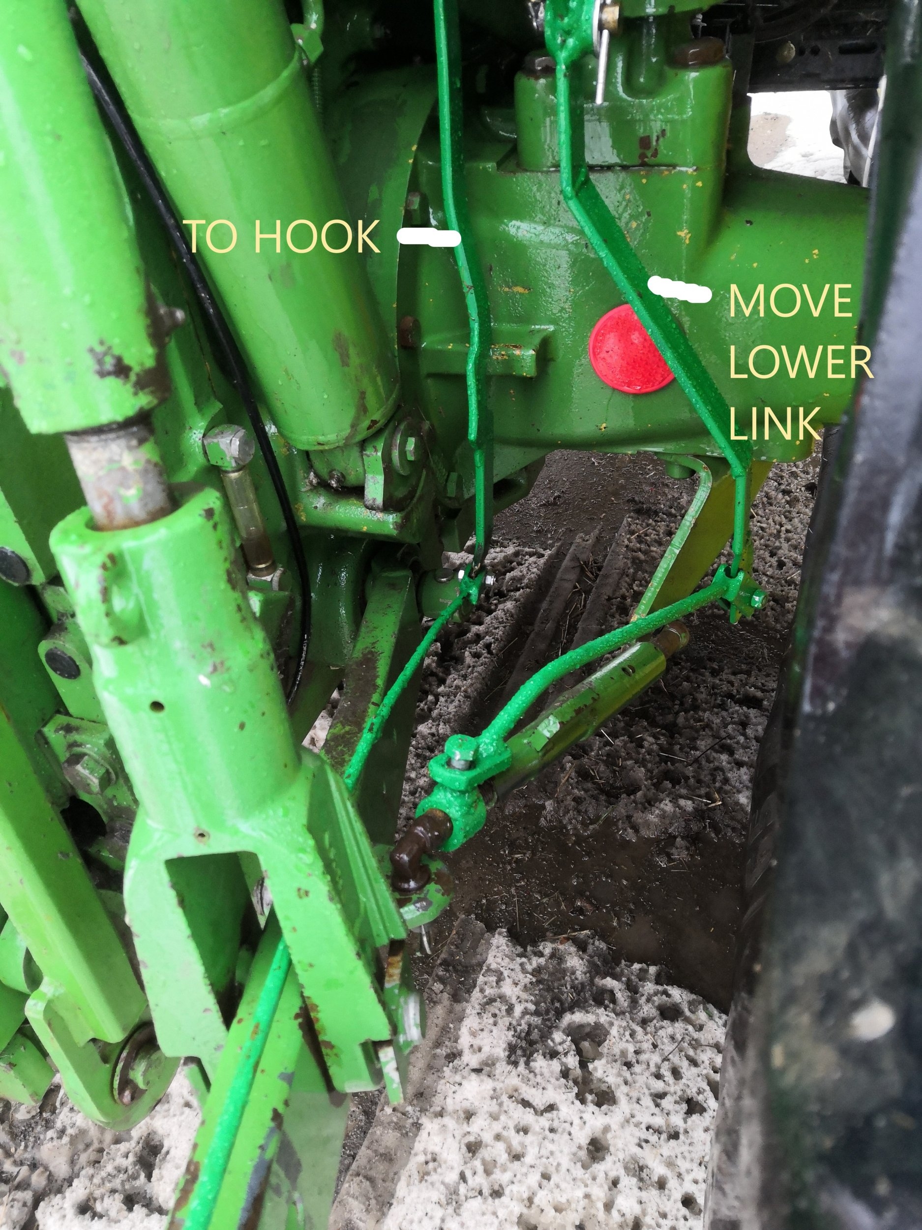

I hope LouNY and others try to make Eurohooks usable from the tractor cabin.
Here is JD and we can move the lower arm with that link on right..
Right arm is moving with the right lever.
Left arm is hold steady.
and hooks

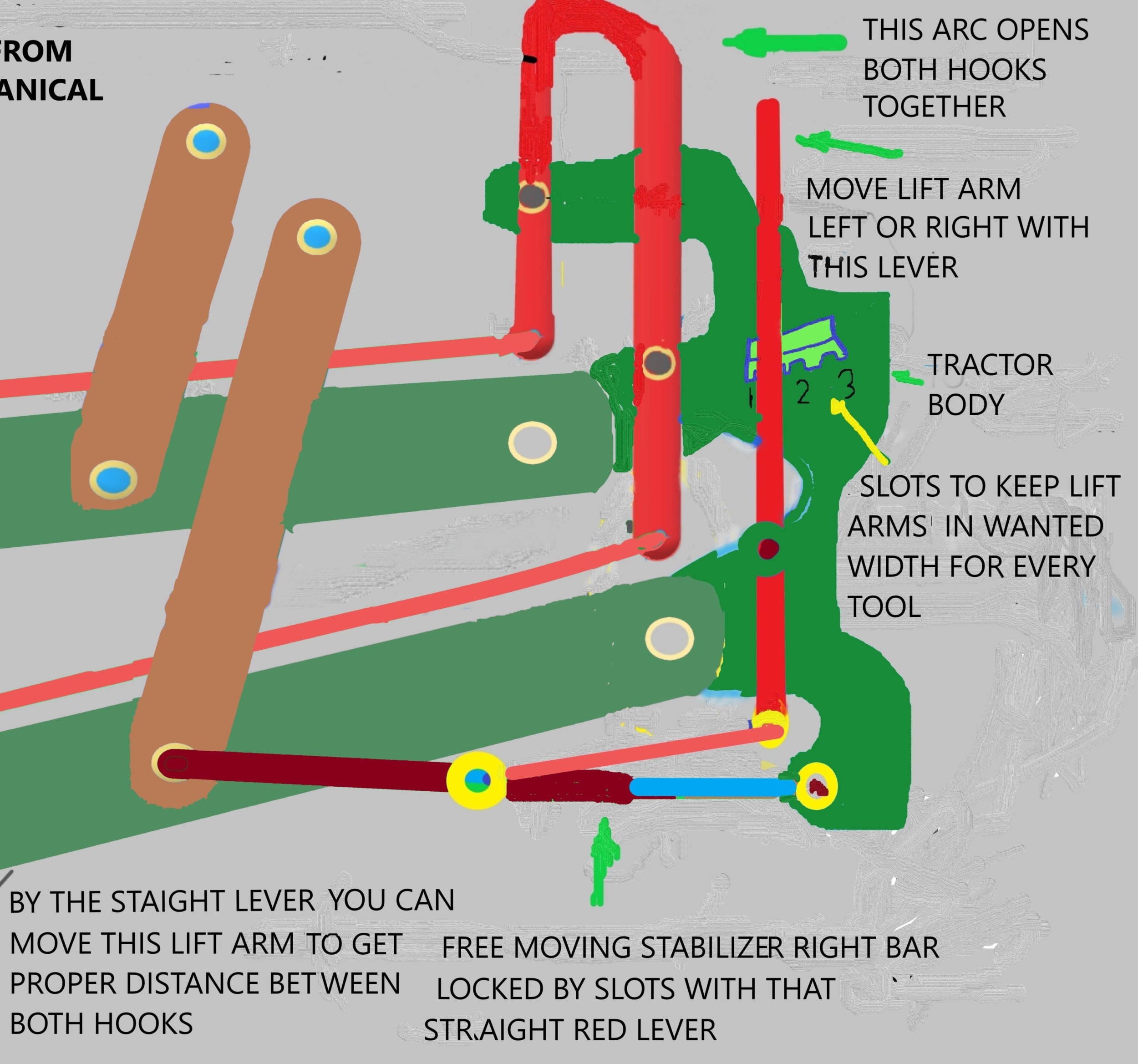

My Universal QH is like next picture.
It works very well, but it is heavy and expensive.
I like Euro hooks and my linkage from the cabin is what You are seeking and comes to spread.
