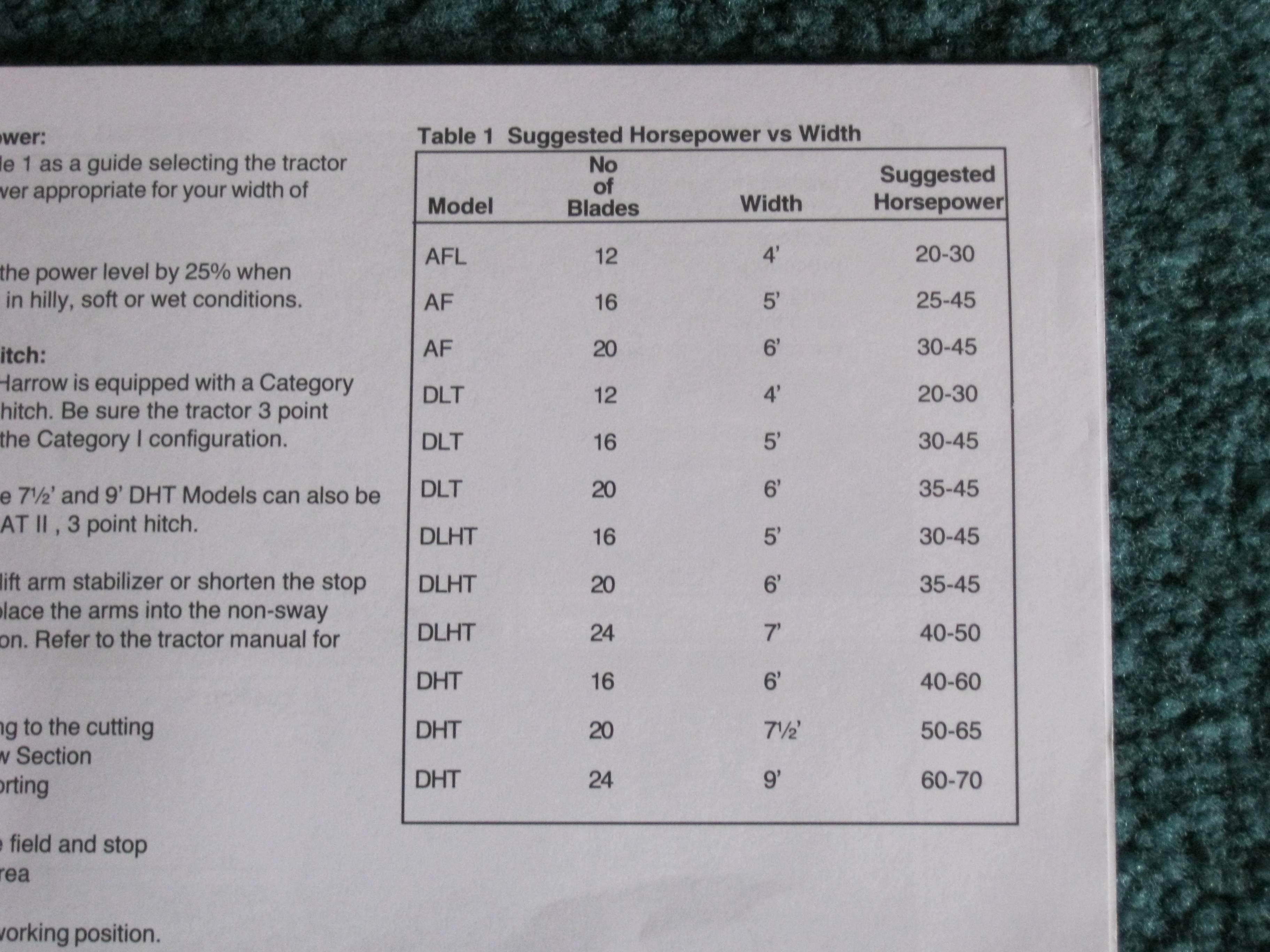

Then your hardest choice will be how much you want to spend on your rebuild project. Whether you buy disc made in USA/Canada/Brazil or India. These here on my A@B Eagle line are made in Canada.

Nice looking disc, Boone.. how wide is it, and what does the Kubota think of it? Mine is just over 6 feet wide, a bit less aggressive and it has no trouble pulling it.

Howdy Sean ! I call that my "parade" DH. :laughing: ! I've never used that one it has sat bout 5 years new in my shop. I'am not a BS artist I had previously posted that it was an A@B Eagleline well I went back to shop with my glasses and found a model # on it on a plate. Also have original manual turns out its a Howse. 6 foot wide plus say it weighs bout 655 lbs.
However over at a buddy's ranch(4 food plots only) I pull a KK I'd say same width and maybe 650 lbs. smooth disc not serrated in 2 ND/ 3 RD gear low with no trouble.
The other little 16 disc in pic is a Semco. I posted a pic of a BB with it cause I got them together off CL to resell/trade.
Which I since have. That one was to light and short for our tractors. Pulled like it was not even there.
Ever owned stuff you haven't used yet or knew what it was ? :D ;)
