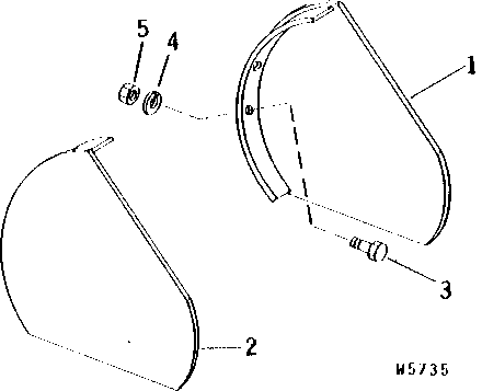

I was considering a box blade for my driveway until I found that I could get end panels for my JD blade which came with the tractor. I don't need scarifiers and can always add weight if needed. So far, my only complaint with the blade is the material I loose off the side and the end panels should solve that problem.

Dcyrilc, that might be a good solution for me? Were your side wings for the bucket a lot cheaper than a box scrapper or about the same? I really like :D the idea of looking forward instead of behind me when I tune up my gravel driveway up in the spring. Thanks for the idea, KC

I haven't bought them yet, but they're $170.00 for each side from the JD dealer. I'm going to make a cardboard maukup (don't think I spelled that right) to use as a jig and have a local shop make make me some out of 1/4" plate. Shouldn't cost more than $30 or $40 per side.
The attached pic is from the JDparts website. This should be a relatively simple thing to create.

Opps, I meant side wings for my front blade not bucket. Thats another great idea to have the parts fabricated by a local company. I have had replacement parts fabricated for my wood burning stove and they were made faster,better, and cheaper than ordering the O.E.M.'s from the stove company. KC
