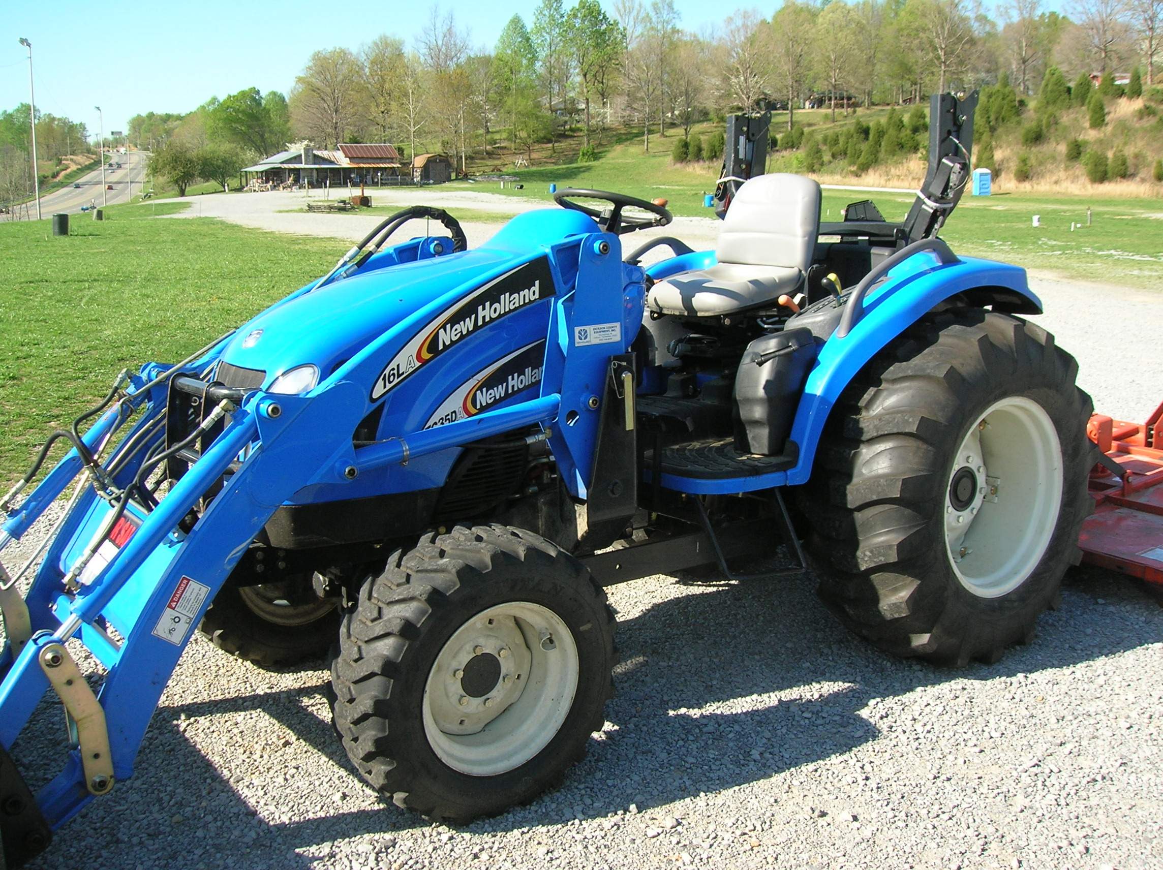

I am in the process of trying to buy a 2004 TC35DA with 16LA FEL. Most of the TC35's that I have seen have a pretty fancy looking joystick for the FEL that resembles something out of an F-16. The tractor I am looking at has the traditional "knob on a stick" look to it. It looks to be the factory set-up and I was wondering if the fancy joystick was an option or what. Thanks for the heads-up in advance.

The tractor definately is the DA version. HST, padded operators platform, swivel seat, etc. The rabbit/turtle switch is not on the FEL joystick. It is on the panel next to the PTO and 3 point controls. Attached is a picture of the unit.

Was that picture taken in Dickson, TN by chance?

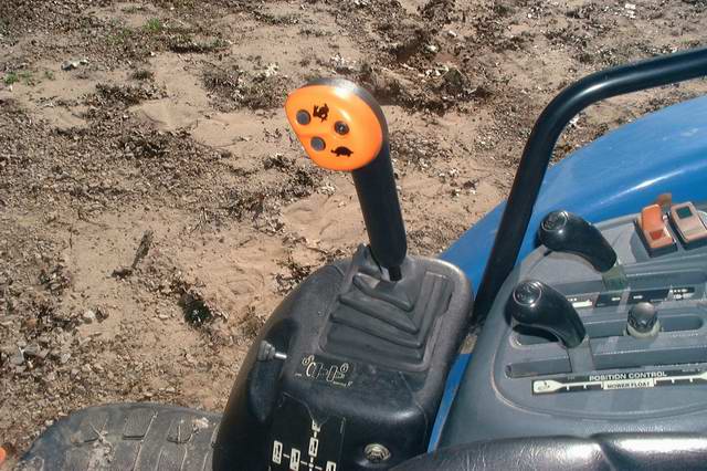

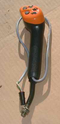

There is no date code built into the serial number, but I can tell by the style of the tractor that it is at least late 2003 model or later. Sometimes you can find date stamps on fiberglass panels or on the inside of the rims (inside tire) where manufacturing dates are stamped or there is a sticker. I wouldn't really worry about it because that is certainly a later model "DA" tractor that looks very nice in your picture.
I'm including two pictures of the joystick. One is the new stick right out of the box and the other is it installed.

If the joystick is located near to the NH OEM location, I think you could replace the joystick with a rabbit/turtle one. The harness connection for the switch is probably there since it is a function of having the HST rather than having a FEL. You might talk to your dealer or look for the harness and connector yourself. You can see what the connector should look like by the connector shown on my joystick in the attachment in my last post.
