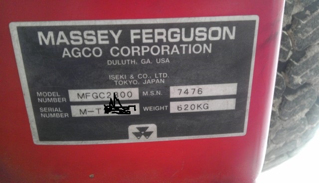

I've found 3 used Massey Ferguson GC2310's within a 6 hour drive,
all of which have a comparable number of hours on them (50-150).
If I get the serial numbers from off the tractors,
can I tell when they were made?
For example, the one serial number that I've gotten so far, is:
GC23008006
Is the date of manufacture encoded in that serial number?
Can I phone up Massey Ferguson, and ask when a serial number
was registered as being put into service, so I can see how much
more warrantee is left on a particular tractor?

MASSEYDEALER said:
That is not the right ser. #
Where is the serial number located on a GC2310? What form should it take?
If that's not serial number for the tractor, what might it be the serial number for? The backhoe? The loader? Supposedly the seller got it off his tractor.
I've not yet seen his tractor, as it is a 8-9 hour round trip away.
   / question about GC2310 serial numbers #4
The Ser # is on the left fender at the bottom next to the floor board.
It will read something like this for 2006 and up JPA 00000-----I made this # up but it will look just like it. For 2005 and older it will read N-T0000. Good luck

The "GC23008006" that you were given appears to be the number off of the right side frame as mine has a similar number there... As MasseyDealer pointed out there should be a sticker/label on the lower left fender above the floor board.

I found out serial numbers for 2 of the 3 used GC2310s that I'm considering:
JRA 20544
JPA 25142
   / question about GC2310 serial numbers #8
n = 2004
p = 2005
r = 2006
s = 2007
t = 2008
NT#### is 2004 production. s/n format changed at beginning of 2005.
O & Q are not used because they can easily be confused with each other and the number 0.

jeepcj7 said:
n = 2004
p = 2005
r = 2006
So:
JPA 24627 # made in 2005
JPA 25142 # made in 2005
JRA 20544 # made in 2006
Are there any (significant) differences between the ones made in 2005 and 2006? For both of the JPA serial numbered tractors, the fellows that have them for sale are telling me that they are 2007 model year tractors... (maybe that is when they got them on their lot?)
