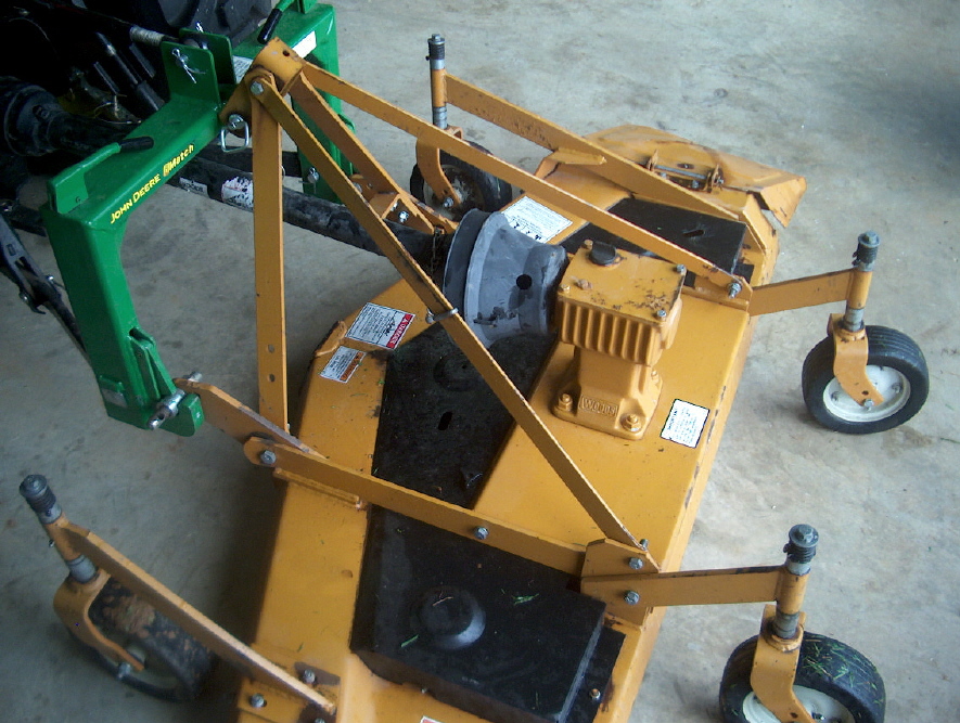

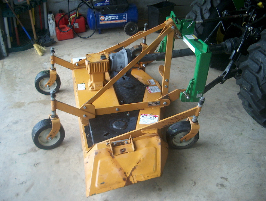

I talked to the guy and he isnt willing to let go of enough cash to make it work. In the meantime, I just got my Woods RM550 and I think I did pretty good. It is raining so I just got to mow for about 30 seconds and all seems well. I dont know for sure what a good price is, the only new one I could find was $2180 before shipping, that sounds pretty high. Tell me what you think is a fair price for this. I am gonna try and post a pic. Best of all, it hooked right up to the iMatch.

here it is(I think)

and another
   / Question about going from 3520 to 2210
try again
