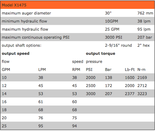

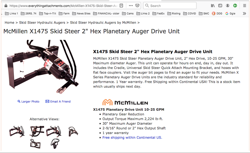

You should have no concerns about running a hydraulic auger on a KX40 since I run a McMillen X1 using a SSQA on the front of the M59. I run bits up to 36" dia ( tapered bit for larger trees ) and have several 12 inch bits ( dirt teeth or rock teeth ) with no stalling issues. Specs attached.
The M59 has a stick to control FEL with 3rd function buttons for controlling the auger or anything else on SSQA. Bind up on a rock and shift into reverse and back it out. Really handy in rock strewn NC. Can't put a shovel into the ground without hitting something at least basketball size.
The KX04 auxillary circuit has flow of 17gpm and this is within the flow requirments for brush cutters ( typically 15-25 for "low flow" and 20-35 for "high flow" machines )
