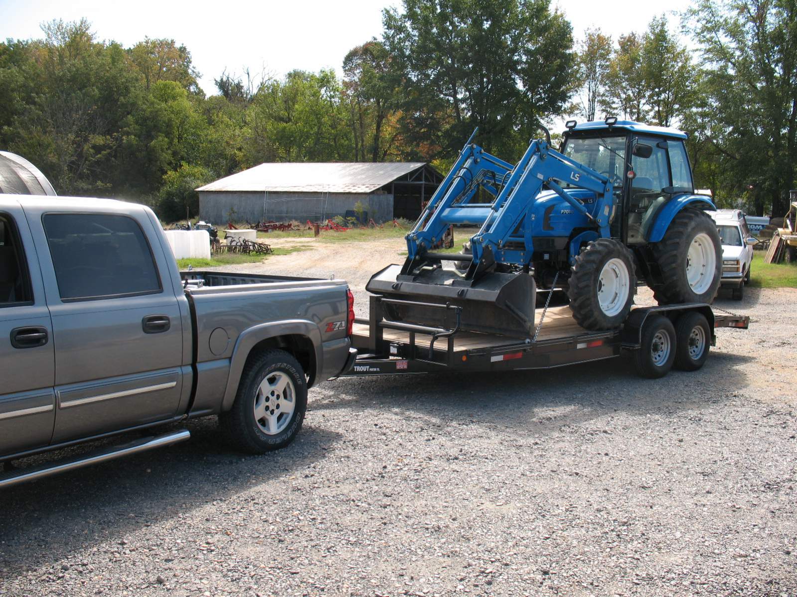

IMG_1135.jpgOh and don't get a trailer with fold over ramps, you loose about 3-4 feet of space to fold them over. I don't like the fold up (stick up in the air at 90 degrees) either as they create wind drag even when empty. I prefer the slide in from the rear type with good heavy angle iron construction. When you aren't using them, they stay neatly stored out of the way. You will need some blocking or jack stands under the rear of the trailer to keep from kicking your truck up in the air when loading. I can load my tractor without blocks if it is flat ground or if the truck it facing uphill but with a bit of slope, it will take off down the hill when you get the front wheels up on the trailer so then you either have to back off or quickly get the rears up on the ramp to stop it from sliding down the hill. Best (safest) is with jacks under the back end. I have some automotive jack stands now but have been contemplating putting 2 of those fold up jacks (one on each corner) like is on the front of a lot of utility trailers which I think would work very well but would need heavy duty ones.
Here is a picture of my truck/trailer/ tractor on my 20 foot trailer. As you can see when balanced, it has a bit of room in front probably enough for a boxblade but on the rear if I had on a bushhog it would have to hang over the tail end. I think I would have to back on with the bushhog high in the air to clear the box blade and let it set on top of the box on the boxblade and then I could balance the load ok and still haul all the equipment that you mentioned.
   / Question about trailering a LS R4041 #8
Another thing with the trailer, don't get one with used passenger tires like the utility trailers. You need at least 5K(mine is 6K) rated axles with brakes on both axles and load range E trailer tires to be safe. The utility trailers with their 3500# rating is pushing the envelope and most of them only have either no brakes or one axle brakes. It was only $150 more to add brakes on the second axle when they were fabricating it. I got my trailer from Trout Trailers in Conroe for $3150 which was the cheapest place I found for a quality trailer. It even came with a spare tire, all 16" load range E tires. Note the heavy duty jack stand in the front, it is spring loaded and the foot adjusts up or down so you don't have to crank for 10 minutes to raise and lower it, just take the weight off and pull the pin and it pops up.

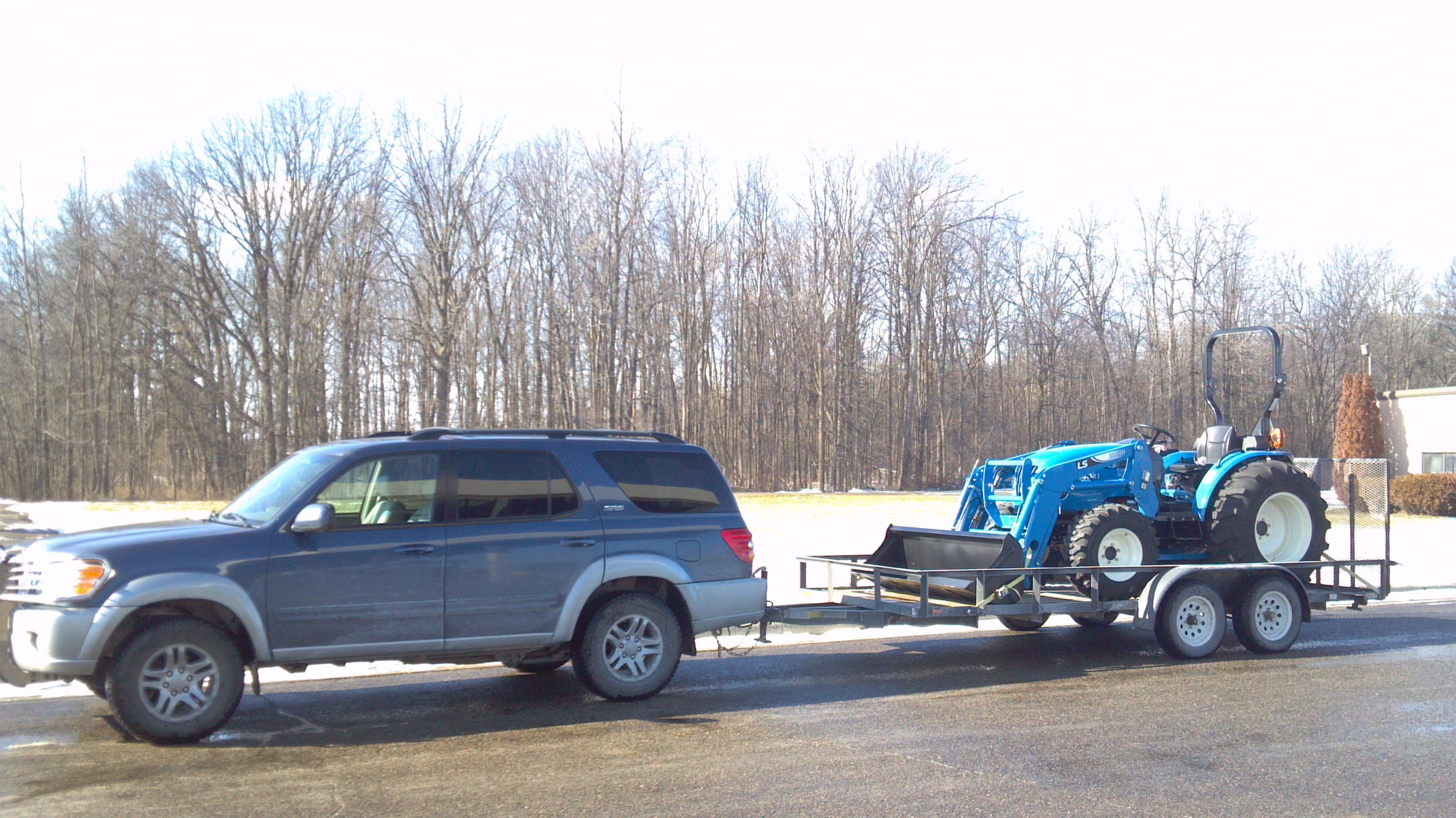

Yeah, that truck should be able to pull the tractor with no problems... Pulling is one thing, but handling is another. My old (04) Sequoia has a 4.7L v8 with only around 240hp/315tq ... and weighs around 5200lbs, which is close to what your truck weighs I would guess. Mine can move it along, but is definitely being worked hard when I'm accelerating up hill on "on ramps" trying to get up to speed. But when you add the weight of the tractor (with loader, mower, etc) you're well over 5000lbs, and my trailer weighs 1500lbs, so that's alot of weight for any 1/2 ton in truth, especially mine. Then again, my SUV isn't really designed for heavy towing, and I'm sure your truck will handle it better. Make sure you have trailer brakes though, as that much weight can really move your truck around at speed.
And speaking of the trailer... the trailer I use (pictured) is not made to handle a load like this. Yeah, it's dual axles are rated at 3500lbs each (and at least has brakes on both) but like Gary says, it's not a car-hauler and the Angle-Iron construction might bend with too much abuse. I never intended to have a tractor this big when I bought the trailer, so shame-on-me for not buying a heavier-duty one at the time. Probably next year... I will only use this trailer with the tractor for "must-use" applications in the meantime.
16' Utility trailer, rated for 7000lbs total (minus 1500 of trailer weight) so max weight on top is 5500lbs.
