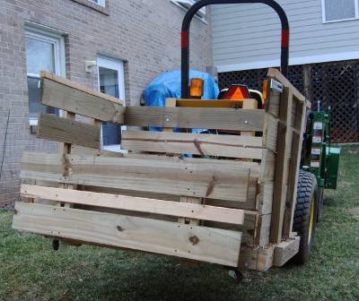

   / Question-Carry All for Compact Utility Tractor #5

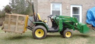

Put the Carryall pins in their lowest position. Should be okay.
Below are pictures of the carryall on my 4010. Loading the carryall about 1/2 to 2/3 full and the FEL full makes the load very stable.

Thanks to everyone for your help and suggestions for a carry all. I bought the TSC 1,000# capacity model yesterday. The two lower pin holders on the CA will have to be cut off and lowered for it to lift properly on my Kubota BX2350. I will have to take it to a welder and then built my platform.
Again, many thanks to all of you.
Billy
   / Question-Carry All for Compact Utility Tractor #7
Mr.Ralph
Awesome looking CA you made there!
Almost looks like you could change specs. a little bit, mount decorative type chains on it and start making wooden type swinging sofa seats like people mount on their porches.:thumbsup:
