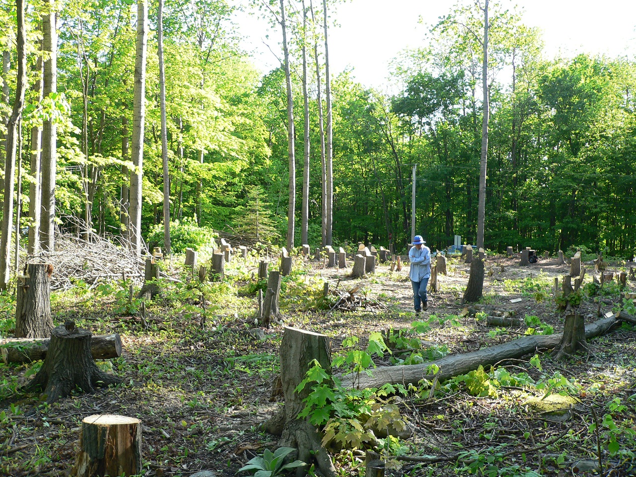

I don't remember the specific model number for the Kioti Backhoe that fits on the ck20... but how strong is that backhoe?
I have a bunch of large stumps that I need to take out, and a lifetime's worth of other projects that I could use it for. IS it strong enough to remove large stumps?
I've got about 40 medium to large size stumps, and I called around for some pricing... cheapest price I found was 1000 to 1500. To rent a large tractor with backhoe, I'm probably looking at 500 to 1000.
I'm sure that the professionals, and the large rentals, would probably make quick work at ripping out the stumps.
but if I bought the Kioti backhoe, Id have 1 available for other projects as well.
what do you guys think? Thanks in advance...

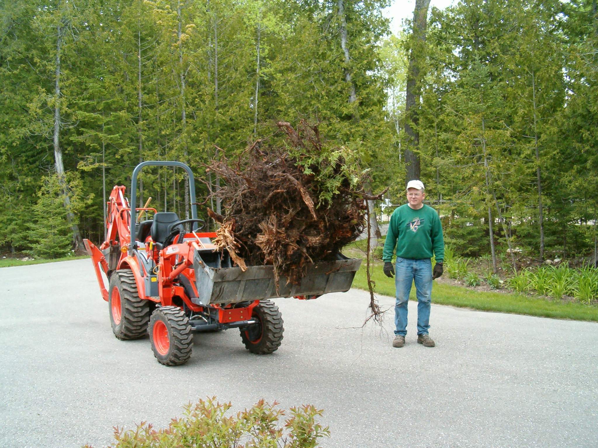

Here are just a couple of the hundreds of stumps my CK20 with the KB2465 backhoe have removed. No question that a CK20 with a loader and backhoe is going to get moved around when it comes to uprooting big stumps of hardwood but I never tackled a stump I could not only dig out but could manage to tip and push it out of the hole. There are of course several helpful techniques to aid in this process. If you plan on making youir ck20 into a stump buster you can increase your efficiency with a couple big feet to increase the size of the stabilizer pads. Also you will achieve less tractor movement if you decrease the length or distance from tractor to stump. The tractor does not move quite as much when the boom and dipper is more verticle as opposed to stretched out flat and long during stump removal.
Another tip most of us already know if you are closer to the trunk and can't seem to be able to bust through a particularly large root one should move outboard with the bucket and attack the root where it's diameter is quite often much less capable of resisting. No question that a larger tractor can be more effective and have fewer hours in the seat for removal but the ck20 will surprise many folks with it's capability. Drive the teeth on bucket strait down as deep as you can get before curling the bucket. repeat if necessary taking one root at a time if necessary. If the hydraulic valve flatlines let up immediately Repeat if necessary BUT DON'T HOLD STICK BACK IF YOU hAVE HIT THE WALL BY STALLING THE HYDRAULICS. I have come to love the sound of snapping big roots as the powerful kb2465 takes the foolishiness out of a well anchored stump.
So far as rent or own is concerned, the ball is in your court on that one.
