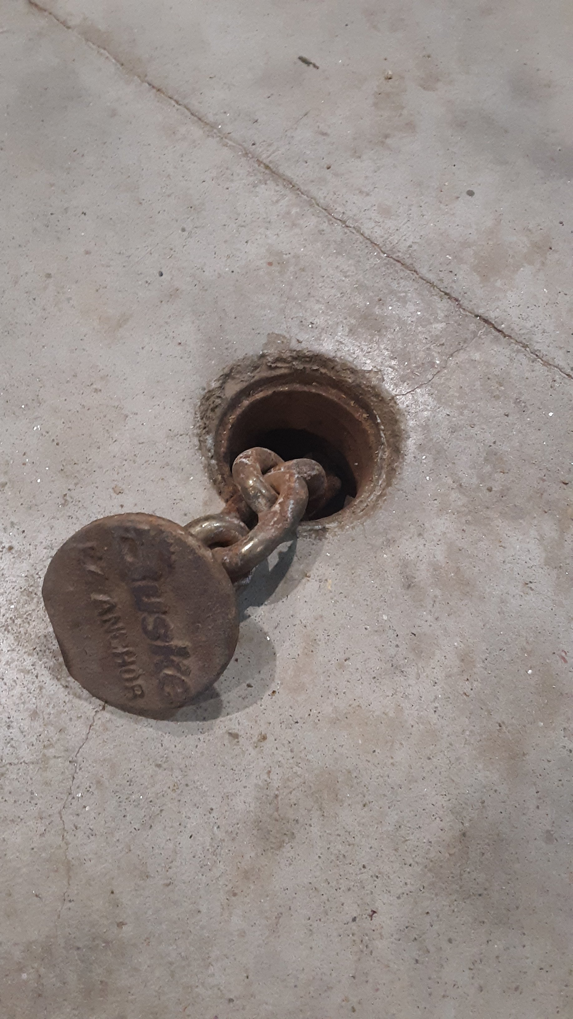

Arrow your welcome to stop by, I put these chain pots in my shop floor. We'll fix it up. 👍
What a great idea, Rusty. I shoulda put at least one of those in when I poured the floor. I would use it to pull non-op vehicles or equipment into the workshop, since my driveway slopes. I recently struggled trying to push a dead mini-skidsteer.
   / Question for shop press gurus #7
It is never to late to add a chain pot in an existing concrete floor. I need to do the same.
