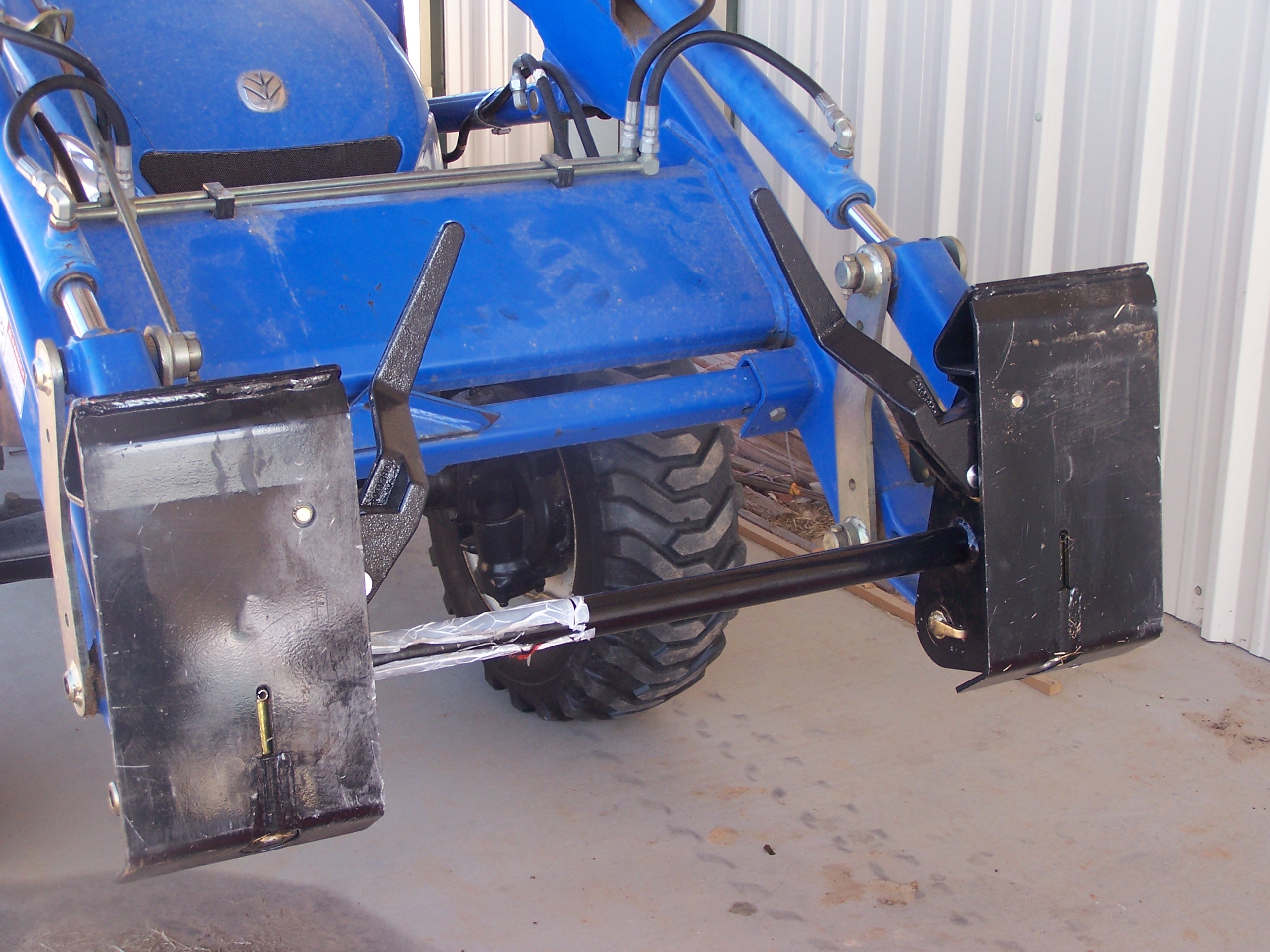

Just got a T1530 with the 250 TL loader that has the Quick Mount feature.
To clarify ... it has a quick attach bucket which I guess was an option. What other equipment can go on the loader and was this quick attach feature made so that skid steer attachments could be used?
I've been searching the internet for a source to obtain forks compatible with the Quick attach bucket feature and even the vendors like palletforks.com and quickattach.com are confused.
Anyone have experience ?

NH Quick Mount refers to easy off, easy on mounting of the entire 250 TL loader on the tractor--I believe.
Quick Attach or SSQA refers to easy to change loader-mounted tools (bucket, forks, bale spear).

The 250TL is the newer version of my 16LA. I switched mine over to SSQA with the New Holland part. Everything I have bought SSQA fits just fine.

So it looks very much like all the skid steer attachments will work with the NH quick attach.
Thankyou for taking the time to post the picture ..... it clarifies my situation.

A bit late but I have the quick attach on my T1530/250TL and I have standard skid steer attachments. Forks, bucket, hydraulic angle front blade. Great to use.

even later here, but my 1530's loader has the skid steer quick attach like pictured above
