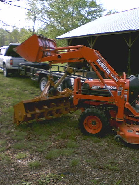

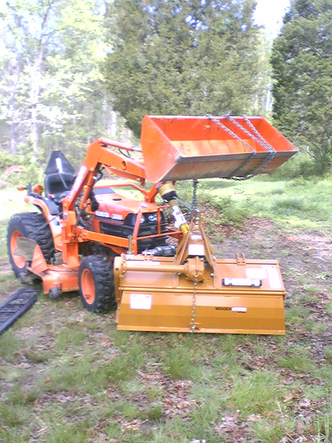

/ Question on a Rotary Tiller
Well, I did it. I bought the Woods GTC52 and just unloaded it .It looks to be a great piece of equipment.I'll find out in a few days.
Donny

/ Question on a Rotary Tiller #8
Congratulations!! That's a good-looking tiller ya got there. I would LOVE to have a rotary tiller. Only problem is I would need one about 84" wide unless I wanted to get an offset model. They're a heckuva lot more money than I've got right now. Oh the trials and tribulations of having a big tractor. Let us know how it does. . . .and post some action pictures!!
