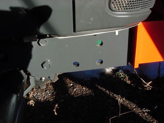

I recall an earlier thread recommending installing bolt-on D-rings on the front part of the frame for chaining to when tieing the front of the tractor to the trailer.
Planned on doing that today, but wasn't sure of where to install the D-rings. Attaching a picture to see if I'm looking at the correct location (almost looks like a clevis could be installed). Comments/advice?

Clevis would be a good idea, also you could chain to your grill guard.

The fast and easy is the grille guard if your not too meticulious. Just run the chain from one side of the trailer, lace it up and down thru the grill guard (bottom frame) and binder it to the other side of the trailer. D-rings would put the chain tension/wear elsewhere but they'd be clanking around a little if you pin mounted them to the frame and left them. Unless you remove them each time. My dealer does the grille guard lace. That's how I intend to.

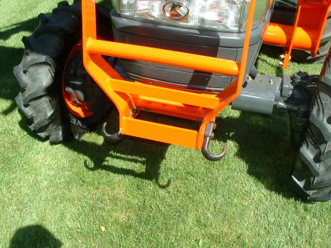

I bolted tow hooks on the grill guard of my L4330 so I could chain it down without scratching any paint. (see attachment)

I put hooks like what GeneD14 posted but I placed them on the frame where your picture shows.
