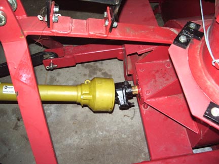

Question: Bought a Meteor 68 this year. Does yours have an exposed PTO coupling at the snowblower end such as mine? I thought the PTO outer bell normally covers the coupling, or there is a missing shield? Also are both inner and outer shaft tubes contained by a separate clip-on chain? It came with a single chain for the outer tube. The manual does not show it that well. Thanks.

The joint is open on the blower end so you can get to the shear pin [bolt] and replace it if/when you break it. The chain between the two halfs of the shield should be connected with another chain that goes to your toplink [or some other convient place] to keep the shield from rotating when the PTO is in use. This chain should be long enough to allow the three point to move in its entire field of motion without breaking it. If you look, you will probably see a cheapo molded zerk on each end of the shield to grease it once and awhile to help it not rotate with the shaft. Good luck :)
   / Question on Meteor 68 Snowblower #3
Forgot.....the chain connecting the two halfs of the PTO shield also is to help keep the shaft from extending out too far and falling apart. If you do have the two PTO shaft parts separate for some reason....make sure you put them back together correctly. The universal joint on each end should be 'in phase' with each other, just like a drive shaft on a car.

The first PTO shaft that I received with this blower was what they call a T50 and was oversized in length and shear spec for this size blower. It also would have been necessary to cut that shaft down to length but that would have also required cutting off the cheap plastic zerk fitting at the end of the outer and inner tubes. Then I determined from the manual that the PTO shaft should be a T40 not a T50.
But I also wasn't sure if the shaft shield at the rear was supposed to cover the entire joint as the T50 bell did to prevent a user from getting snagged. You are correct that the shear bolt needs some access for it to be R&R.

I've got the same Meteor as you and the end of the shaft is exposed just like yours to get at the shear pin - which I replaced just last week!
I have no chain anywhere... maybe I did and don't know what the heck I did with it.
I get the two ends of the shaft apart every so often when I am greasing it. It takes a few minutes to get them together right.
