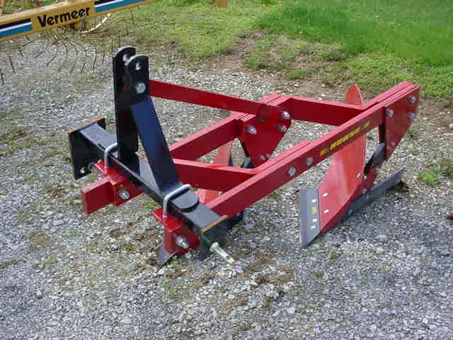

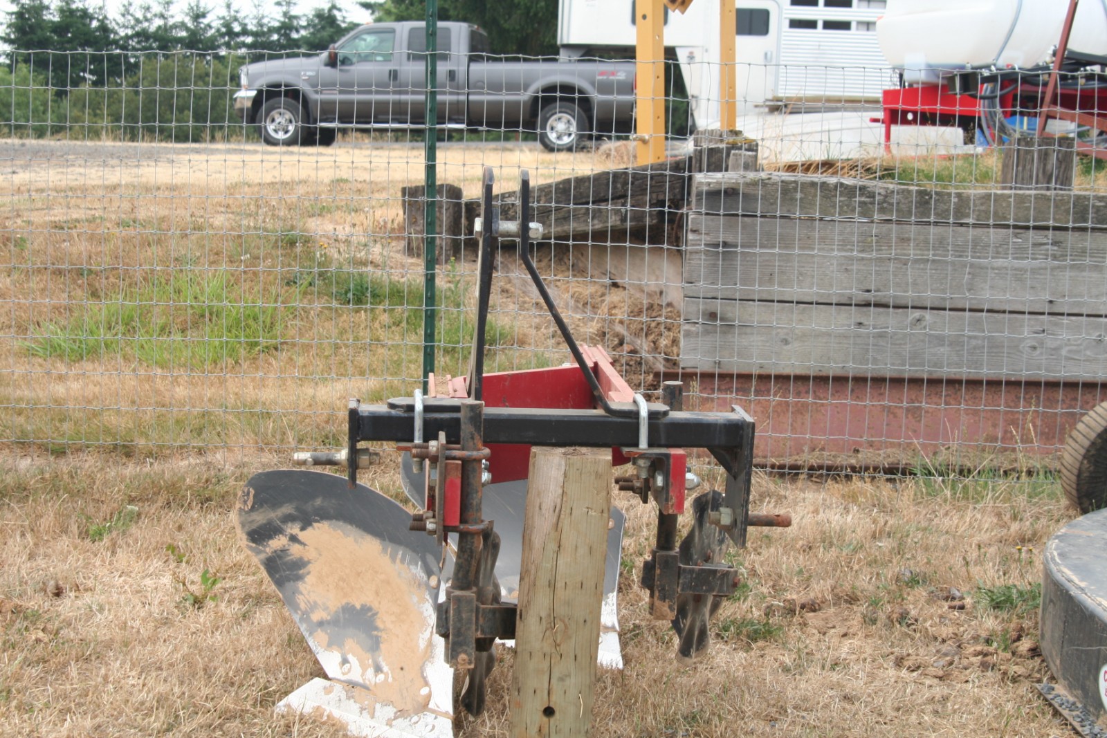

I picked up this plow a couple of months ago. I ran the tractor up on a 7" block with both the left tires and had to adjust the 3pt lift arm on the Right (looking at the back of the tractor) all the way to the top and still it was not level. After looking and puzzleling at it, I believe the 3pt arm pin bracket is mounted backwards. What are your thoughts on this? I have also attached a picture of a Howse 12 x 2 plow for comparison. I appreciate your input.

Yep...I would say you nailed it. Looks like an easy fix.
