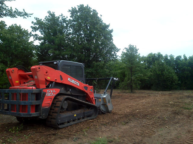

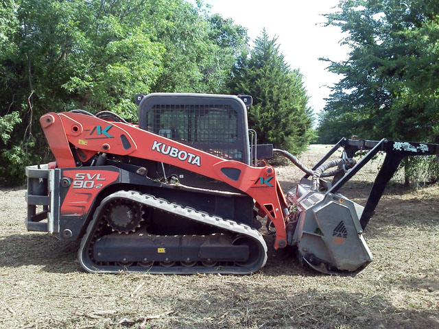

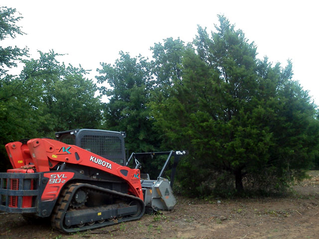

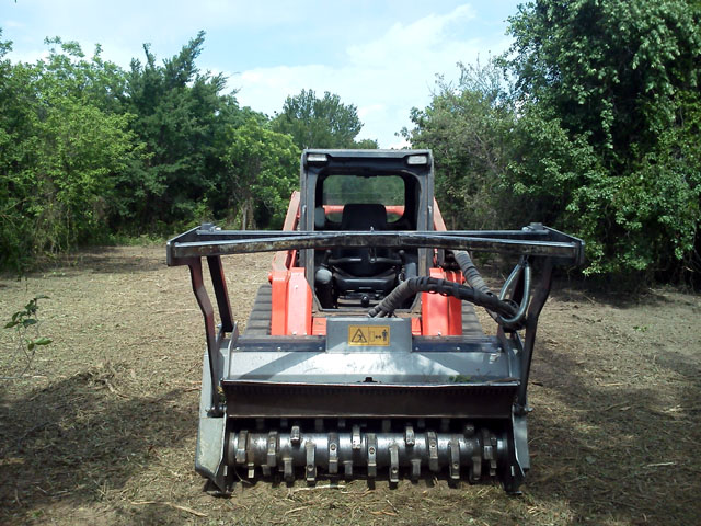

Here's the machine Frisco is talking about.
Mulching before and after shots.
A couple of things I'll mention when it comes to the SVL90 and running a mulcher. The loader towers are fairly open to debris. Most of the dusty stuff can be blasted out with air a couple times during the day (at lunchtime and at the end of the day), but as Yellowdog mentioned, a shopvac is pretty handy. For full-time mulching the machine could use an auxiliary hydraulic cooling system when the temperature is hovering around and above the 100* mark.
