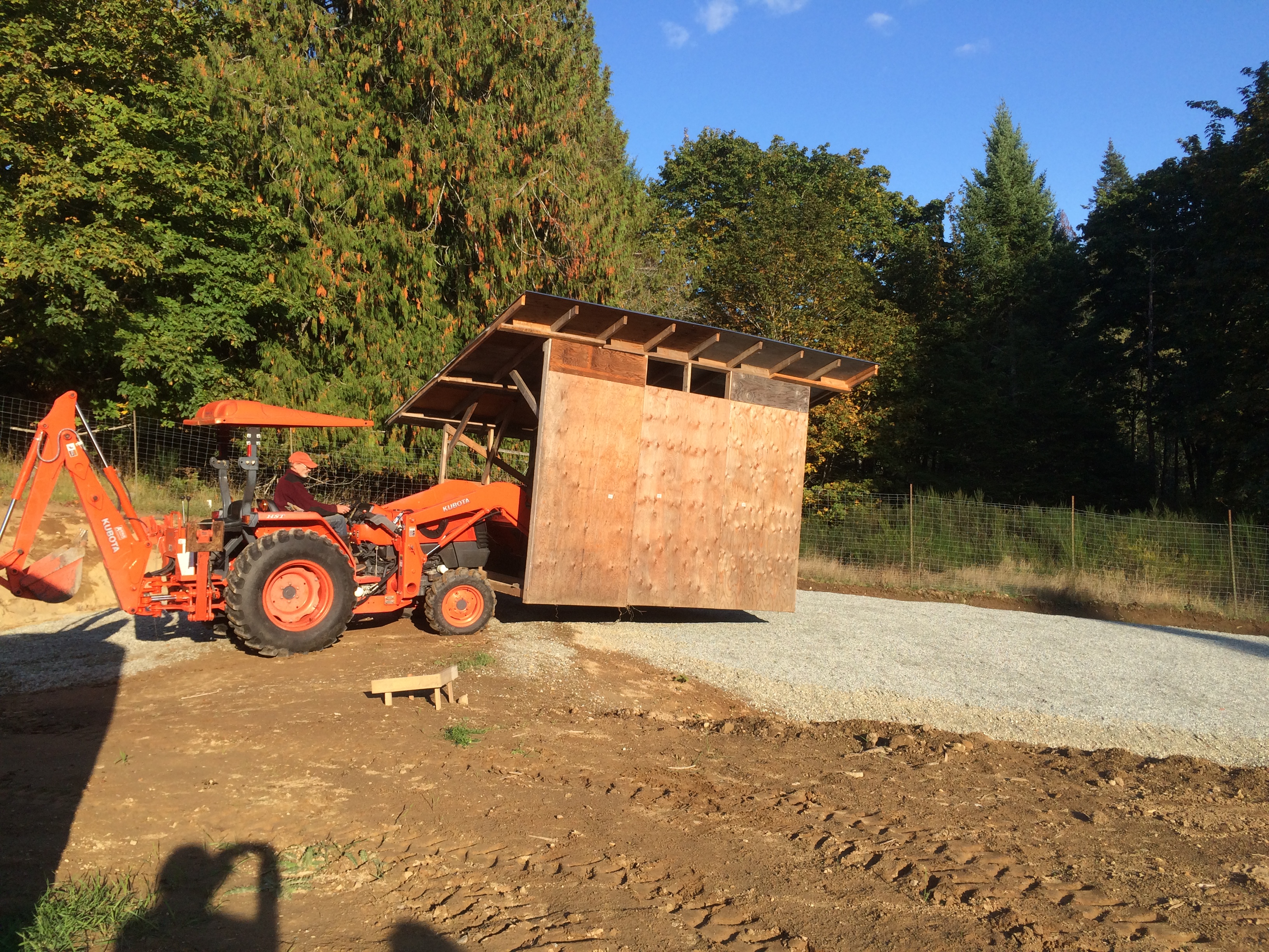

I'll get the parts ordered. I have only had the tractor for 2 weeks and already it has been great help around our small acreage. From pulling out small stumps with the backhoe to relocating a small building. tractors are like the swiss army knife of vehicles.
