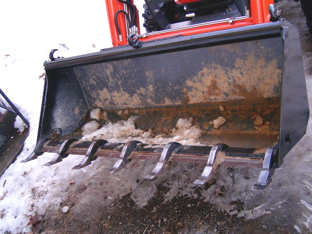

</font><font color="blue" class="small">( How much does a tooth bar cost and how easy does it install? )</font>
I have a WR Long, 60" toothbar was around $300.
Installation is easy.

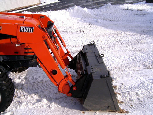

If you don't have the heavy duty bucket you may need to reinforce the top of the bucket for a center hook.
I use the center hook far more than the others.

   / Questions about 790 #7
It slips over and under the bucket edge and 1 bolt on each side of the bucket holds it in.
