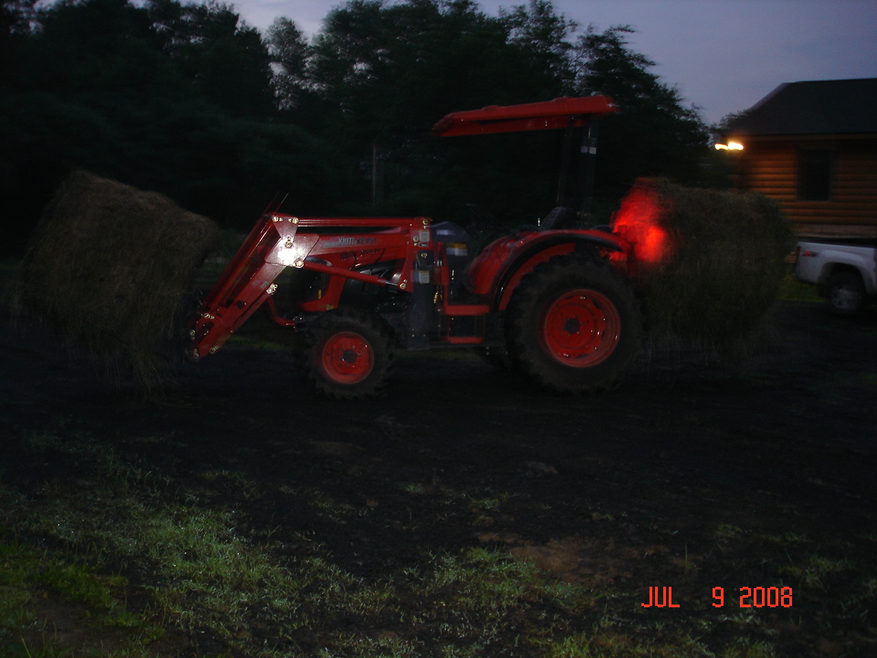

it will handle that job very nicely. i have one, the hydraulics are very strong. mine has the KL551 loader on it. its for sale if intrested.
