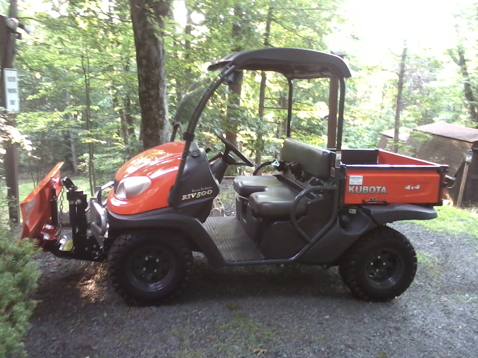

For 15 years, I've been plowing out the neighborhood with a Kubota TG1860G garden tractor with a blade on the front. (The neighborhood is a mix of asphalt, smooth gravel, and not-so-smooth gravel. Also, some is flat and some is hilly.) I just upgraded to a Kutoba RTV-500 with a blade on the front.
And...it's my first time with a blade with skid shoes. I will be honest...I didn't even know there was such a thing as skid shoes until this new Kubota arrived with skid shoes on the blade. Interestingly, the manual for the blade tells you how to adjust the skid shoes, but it gives zero advice on when to use them and when not to use them.
I've done a little research on this site, and the best conclusion than I can come to is that some people believe that skid shoes should be used to elevate the plow blade very slightly above the ground for gravel, whereas some people don't use them at all. My old blade without the skid shoes had an adjustable bottom edge that was supposed to be curved slightly up in the front from snow plowing and supposed to make contact with the ground for grading.
Would like to get opinions/experiences on use of skid shoes with a blade on the front of a medium-sized ATV. In particular, I'm wondering what to do with them on a job that keeps transitioning between asphalt and gravel.
Thanks in advance for your help.

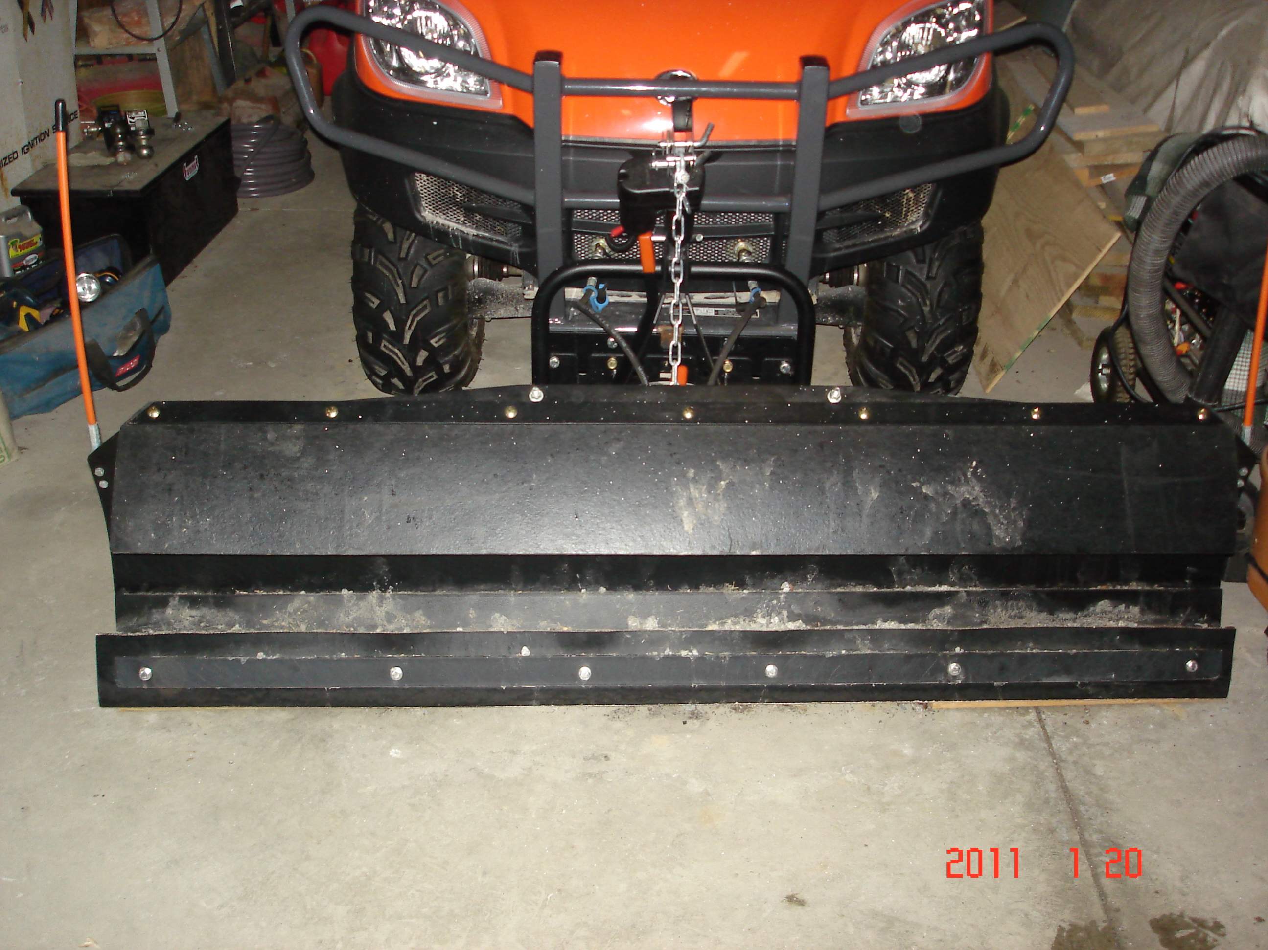

I had an RTV500 and now an RTV1100. On both I pulled the skid shoes all the way up so as to not use them at all. What I did on both was install a 1" rubber strip at the bottom of the plow to prevent digging into gravel and help clean asphalt driveways. This has worked veery well for me over the 8 years I've been doing this way. An old machine belt or rubber horse mat works weel for this purpose.
An RTV500 will move far more snow than you could imagine. I was very impressed with min during some serious snow storms. You do have to keep up with the snow faall though, don't try to move feet of wet snow all at once.
