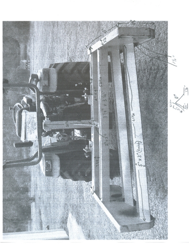

Here are the dimensions from my duragrader. You can buy the blades directly from them if you like.

Thanks Wayne!
Mine is coming along nicely, though slowly.
I hope to have it ready to test next weekend.
Mark
