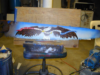

I've done afew garage doors. Cleaning with TSP, dry, then use a scotch brite pad (lightly scuffs) the textured surface, then paint. Speaking of painting, here is one 3/4 done . Last year and this year I decided to air brush a mural and enter it in the Woodstock fair. Last year was a small table with the scene out my front door. This is a cross buck saw blade, (about 75 yrs old) with the Eagle.

Larry - What did you pick as a motto on the saw?
Brian
   / Questions on painting garage door #5
everyone here wanted something and as none of us could agree, I painted stars and stripes through the ribbon,. No more arguing on what saying to paint.. The stars ended all that.
