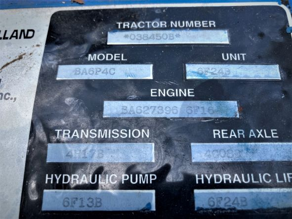

Questions on the numbers on my new to me, New Holland/Ford 3930. I had to pull the hood on my 3930. Noticed it seemed to have fractured paint. Which turned out to be where someone had stood on the hood. Then to fix it the moron decided to put a 1/2" of Bondo on the caved in hood. "Go figure" anyway that is in another thread!
To make a long story short I found the numbers on the inside of the hood. So this image with the numbers, appear at the top of the page. The first shows the data plate as it appears and the hood. The second is the numbers I copied after cleaning the plate and putting my magnifying glass to the numbers.
Now here is the problems I can't find any info that corresponds to those numbers and tractor info! No where have I been able to find 3930 data that shows a model # of BA6P4C. Nor do any of the other numbers correspond to any info I have found on the net. Can anyone shed me some light on where to go to find the info that corresponds to the numbers?

interesting, if you punch in your serial number at CNH it gives you - 038450B - 3430 - 3 CYL AG TRACTOR ALL PURPOSE - (03/90 - 01/98)
A 3930 model should start with a "CA5, CA6, CH5, or CN5", have you compared whats on the tag to what's stamped on the bell housing boss just above and behind the starter? should be 3 lines of numbers. wouldn't have been the first hood swapped out through the years!
the number you show that's cast into the transmission is a part identification casting number, they will not match anything in the tag

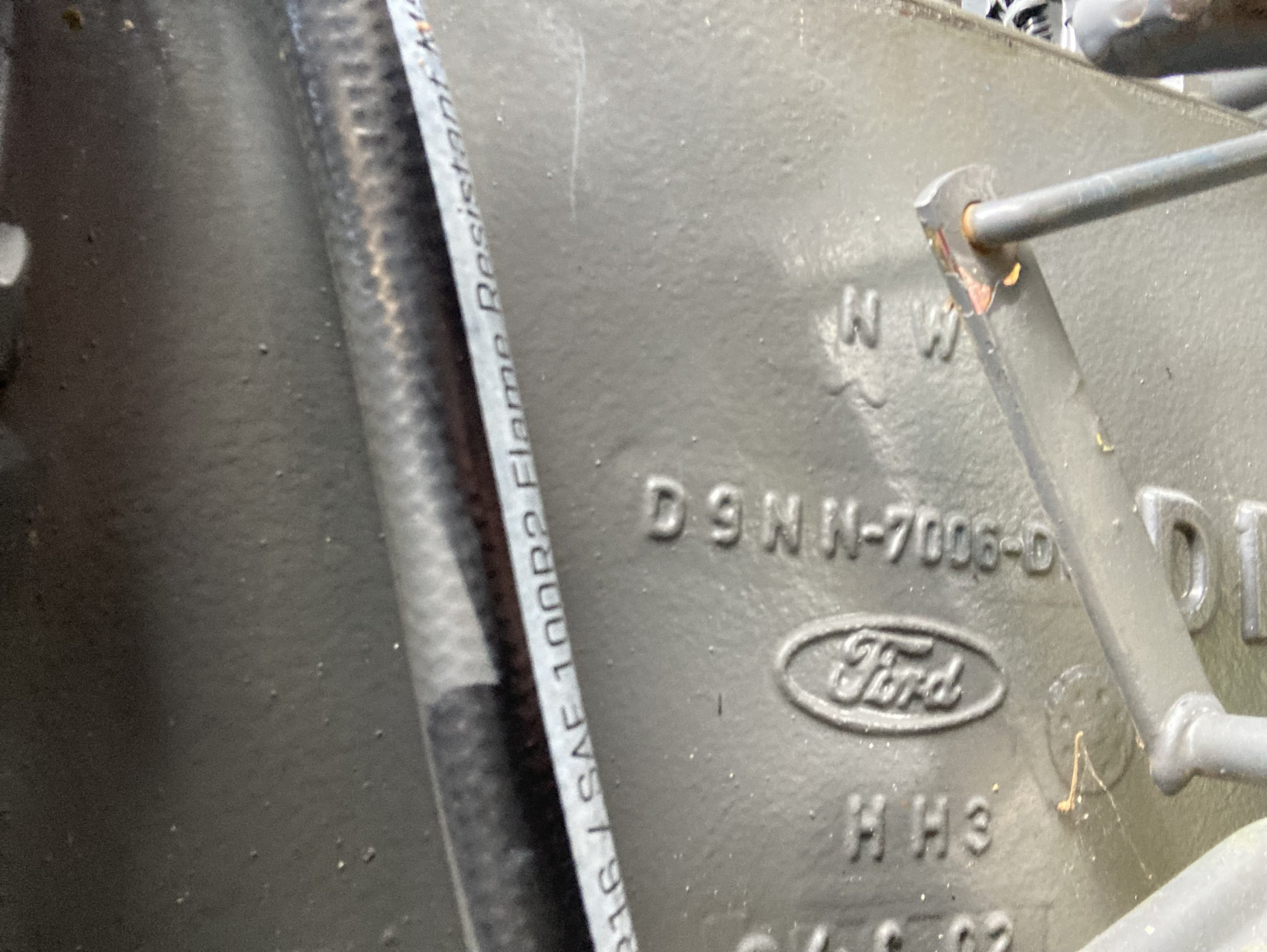

This is an update to the original info. On my tractor the numbers are on the transmission right behind the brakes and the throttle linkage which makes it damn hard to photograph! But here are some pics and then the full numbers as they appear. IMG_1471.JPG
D 3 N N-7006-DB huge block letters DB again.
FORD
HH3
4 0 02
So maybe that will shed some light if I can understand what that all means!
