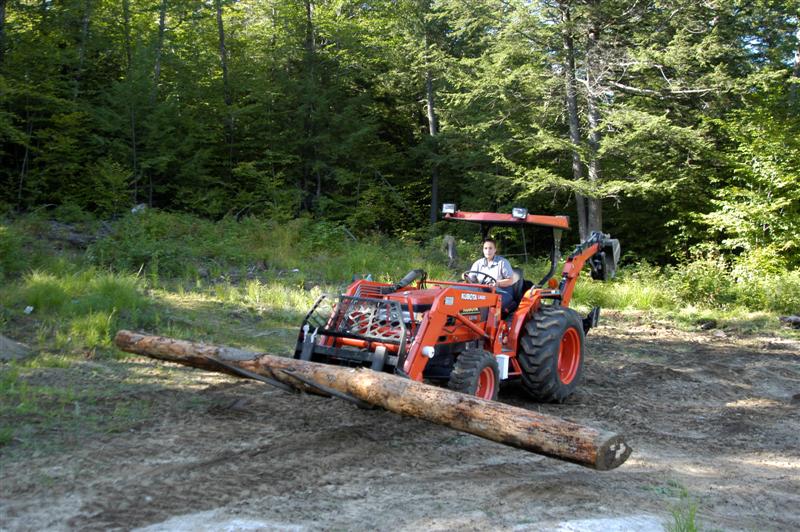

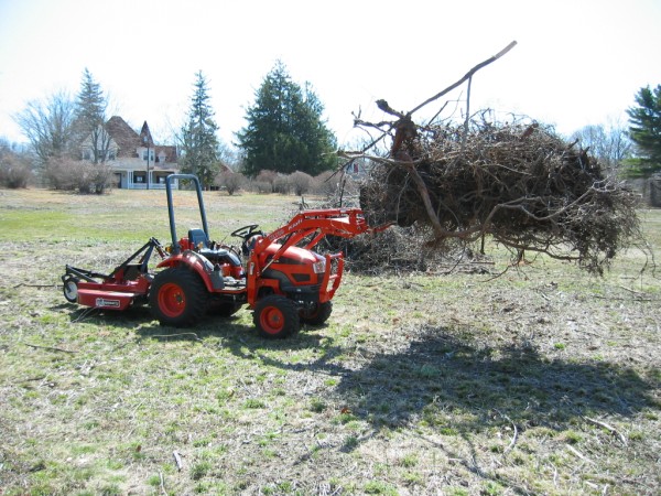

I added a QA adapter to my Kioti loader. I believe the manufacturer was Horst and it is a very good unit. It weighs about 75-100lbs and pushes the implement out about two or three inches so it will cut down on your lift capacity by 100-150lbs or so. My loader has a 1070lb lift capacity measured at the pivot points so I would estimate I still have somewheres around 700lbs in "mid bucket" position. I use my QA with a 280lb grapple and still have plenty of lift power to raise a completely stuffed grapple (with brush) and I can also lift a 12" x 15foot log high enough to carry it.
The ATI product is also nice according to other TBNers who own it. I believe the ATI goes for around $500-600 but I am not sure. I don't know the price of my Horst as it was bundled in a special deal with the grapple but I suspect it would be about the same.

I recently did the math for lift capacity loss on a loader with ~1,000 lb. pivot pin lift capability. The ATI quick attach adds ~3" the loss is 60-80 lbs. Surprisingly little.

I bought an ATI quick attach for my Kioti CK30HST. It is a very well built unit. One of the big advantages of the quick attach is that if you ever change tractors as I did you only have to make sure the new one is quick attach and everthing mounts up. In my case it save me money and hours in changing grapples. The only thing I had to install was the hydraulic lines to the loader and it was useable again.
The ATI is a good unit in that it stays open when changing attachments. Most do, but not all, and the ones that don't are a real PITA. The tractor I had between the CK30HST and the JD3520-Cab did not.
As pdsrms said the lift loss is very small. I have carried logs 14 - 16 feet long and 12" around and it is no problem after they are balanced.
