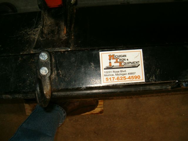

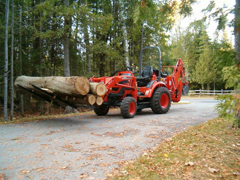

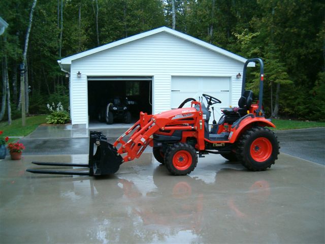

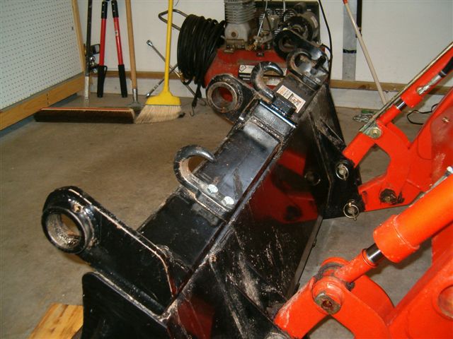

Check out MichiganIrons fabricated bucket forks. I have a set and they are slick. The mounting system also serves to stiffen the bucket. He ship his fabrications all over the U.S. and even Canada. Take a look.

That would make a lot of sense so long as the OP is not considering adding a grapple or other QA implements. The dedicated bucket forks is a FAR better solution than the screw on/chain on types sold over the internet.

For CK20 the pin on forks are plenty good enough. IF you put the forks out in front of the bucket, you lose lift capacity since the load is further out and you increase instability i.e you need more ballast. The CK20 has limited lift capacity as it is. Michigan Iron has a QA for pin ons that is quite reasonable and sufficient for the CK20--- At least I have their QA and pin on forks and I think they works fine.

We have Bucket Grapples that use the same Load Bar as the Bucket Forks. Un-pin the Forks and slide on the Grapple. Once the load bar is on the bucket, we have different bucket tools that use the same Load Bar Carrier. Just a matter of pulling the pin(s) across the top of the bar.
