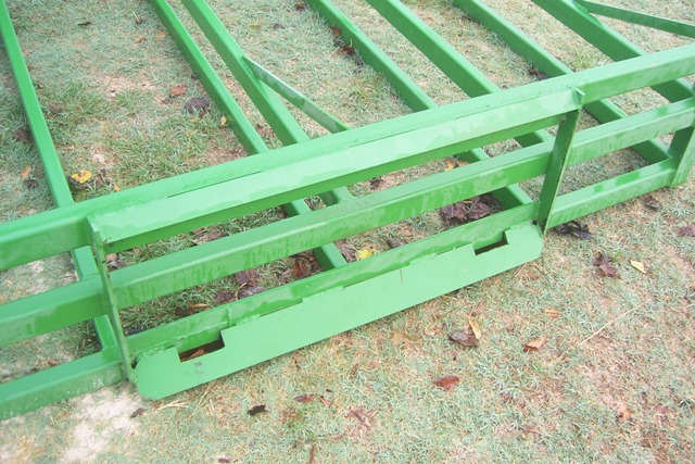

Ouch....they are proud of those adapter plates aren't they..... then I have to weld a quick attach plate to my existing bucket....but I think thats the way to go.

I don't buy the plates ... I just make my own and have had no problems.

Even if you spend $800 for the conversion of your loader arms and your original bucket, everytime you buy another attachment after that, you'll be pleased to never worry about it again. Having the SS attachment on your loader is like turning a toothpick into a Swiss Army knife. Nothing you can do to your tractor will make it more flexible. Even if you don't buy more attachments, you can rent many of them. So yes, it is expensive, but well worth it.:thumbsup:
