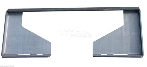

Titan on eBay: 5/16" Quick Attach Loader Cut Out Universal Mount Plate skid steer bobcat kubota
Titan Distributors: 5/16" Attachment Cut Out Mount Plate
2 piece: Quick Attach Plate 2pc 1 4" | eBay

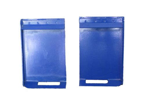

Still not what I'm looking for, I only want the bottom tabs that have the 2 slots per side.
With the exception of the top angled mount the rest will be integrated into the pallet fork frame.
This is what I'm looking for

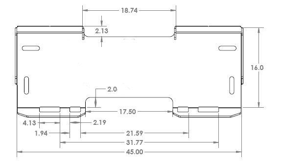

I think you will have to make it yourself.
My WildKat grapple was loose and the manufacturer sent me those tabs to use as shims. It may not hurt to give them a call and see if they'll sell you some.
