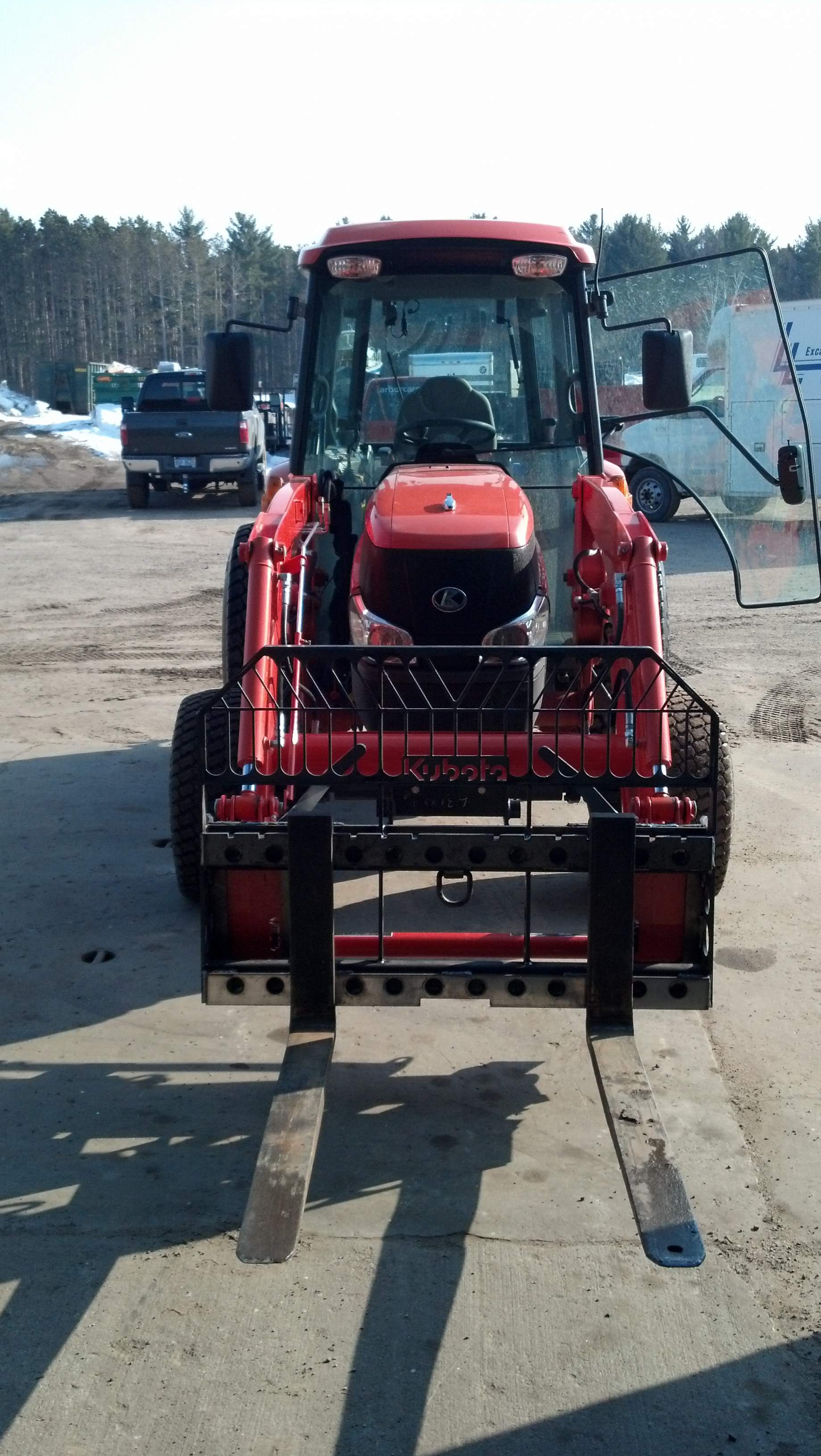

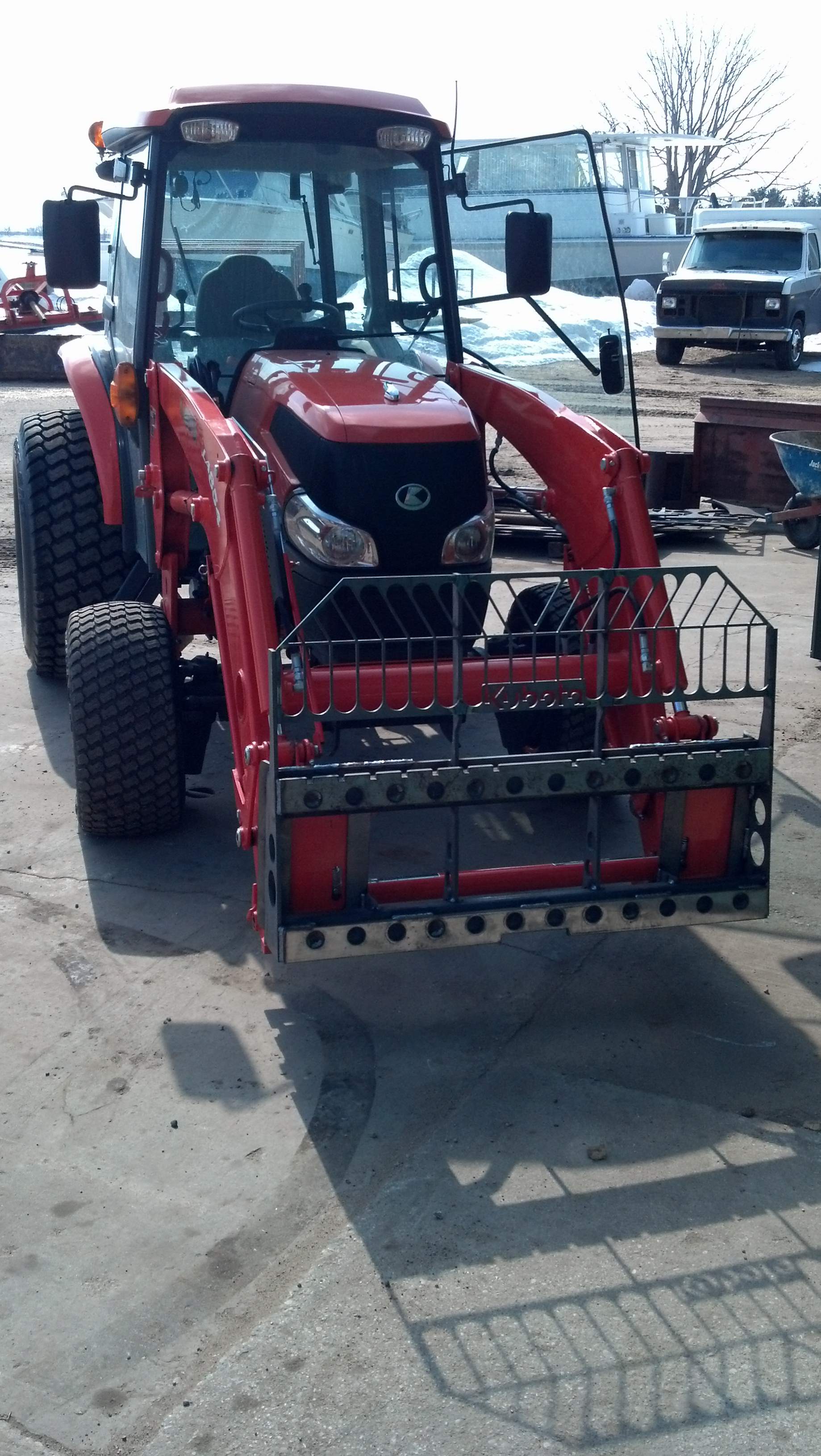

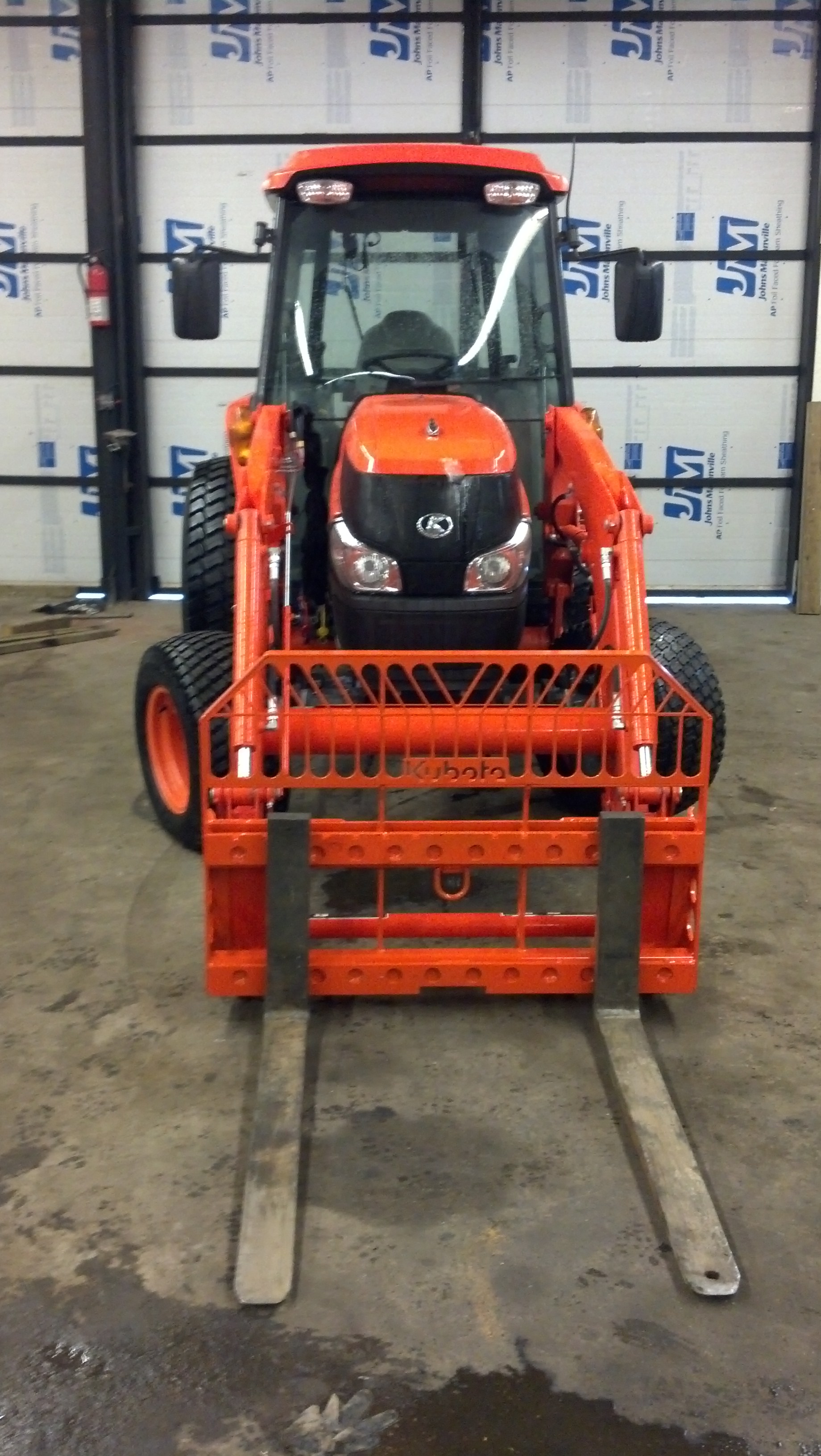

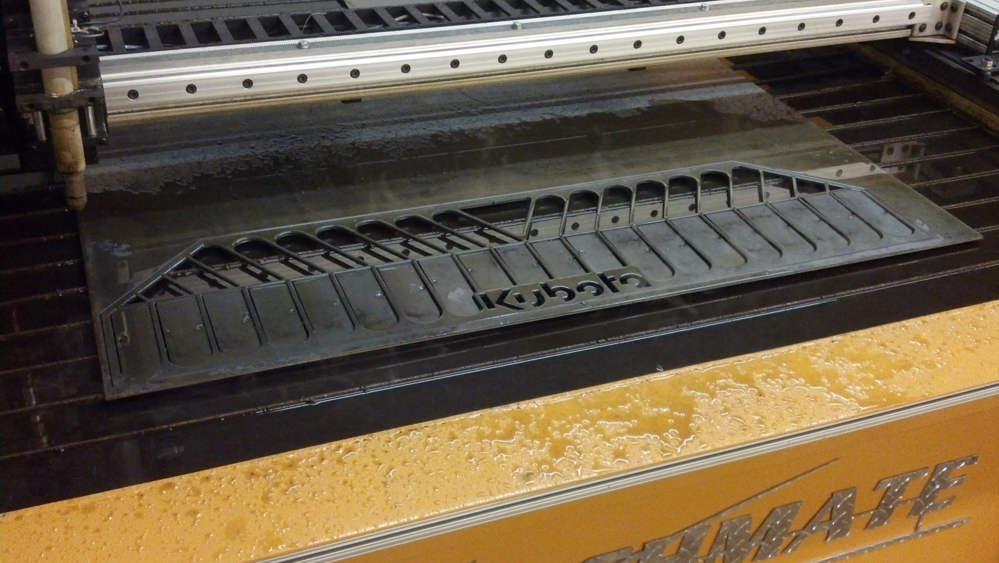

I decided its time to build some pallet forks. I made them to Class II specs and grabbed a used set of 4"x42" tines. Knowing the capacity of my L5740, I tried to keep them as light as possible, while still being strong. Eventually, I'll get over to the feed mill and scale them. Tomorrow they go into the paint booth! :)

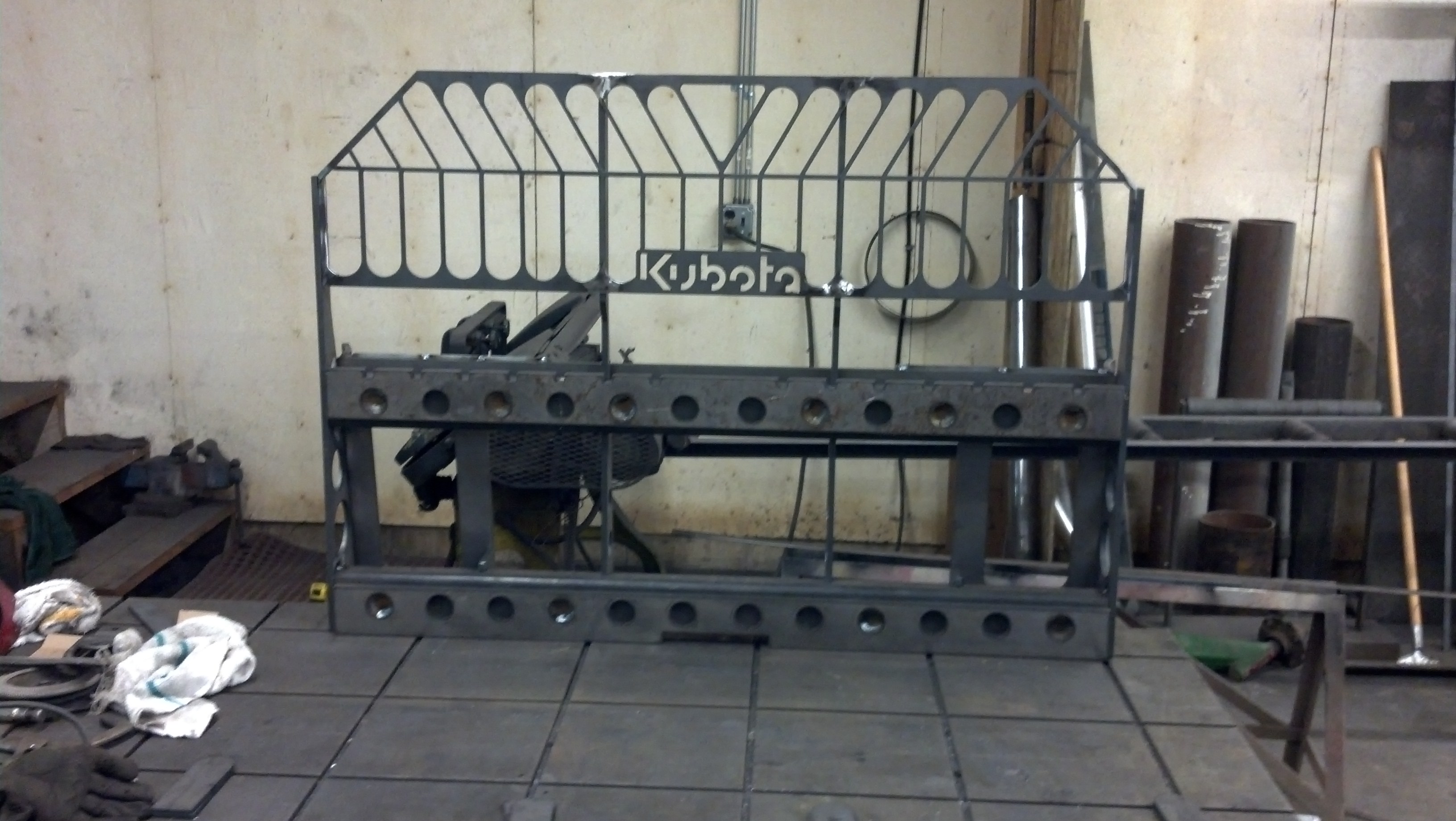

Guard after being cut:
Tacked together, ready to weld:
Test fit before final welding:
Mounted up, with forks:
A video of the guard being cut out:

Is the Torchmate yours or did you have a shop cut it out?
   / Quick attach pallet forks
It belongs to a friend of mine. I helped set it up and run it, so he lets me cut things out for myself.

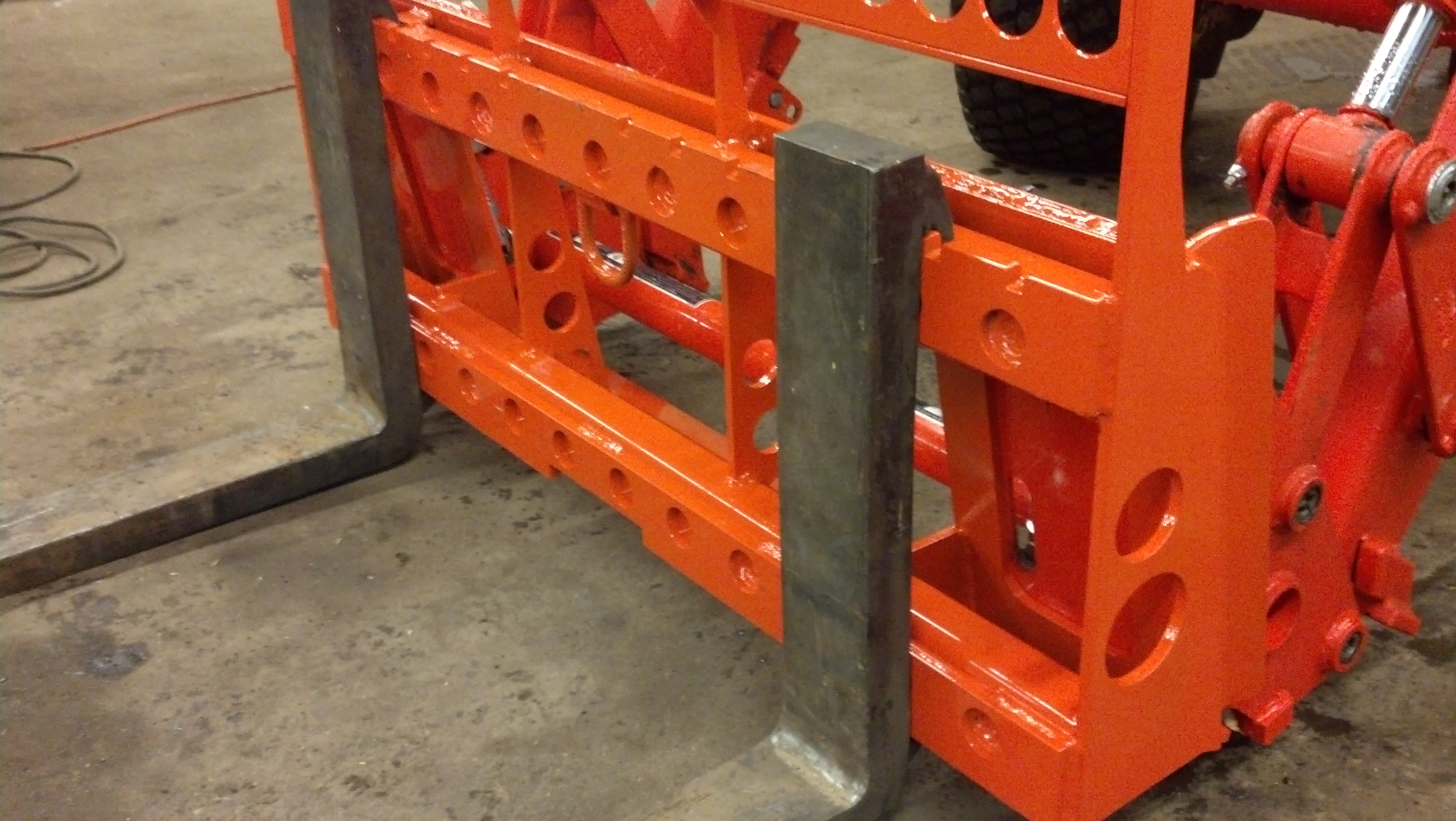

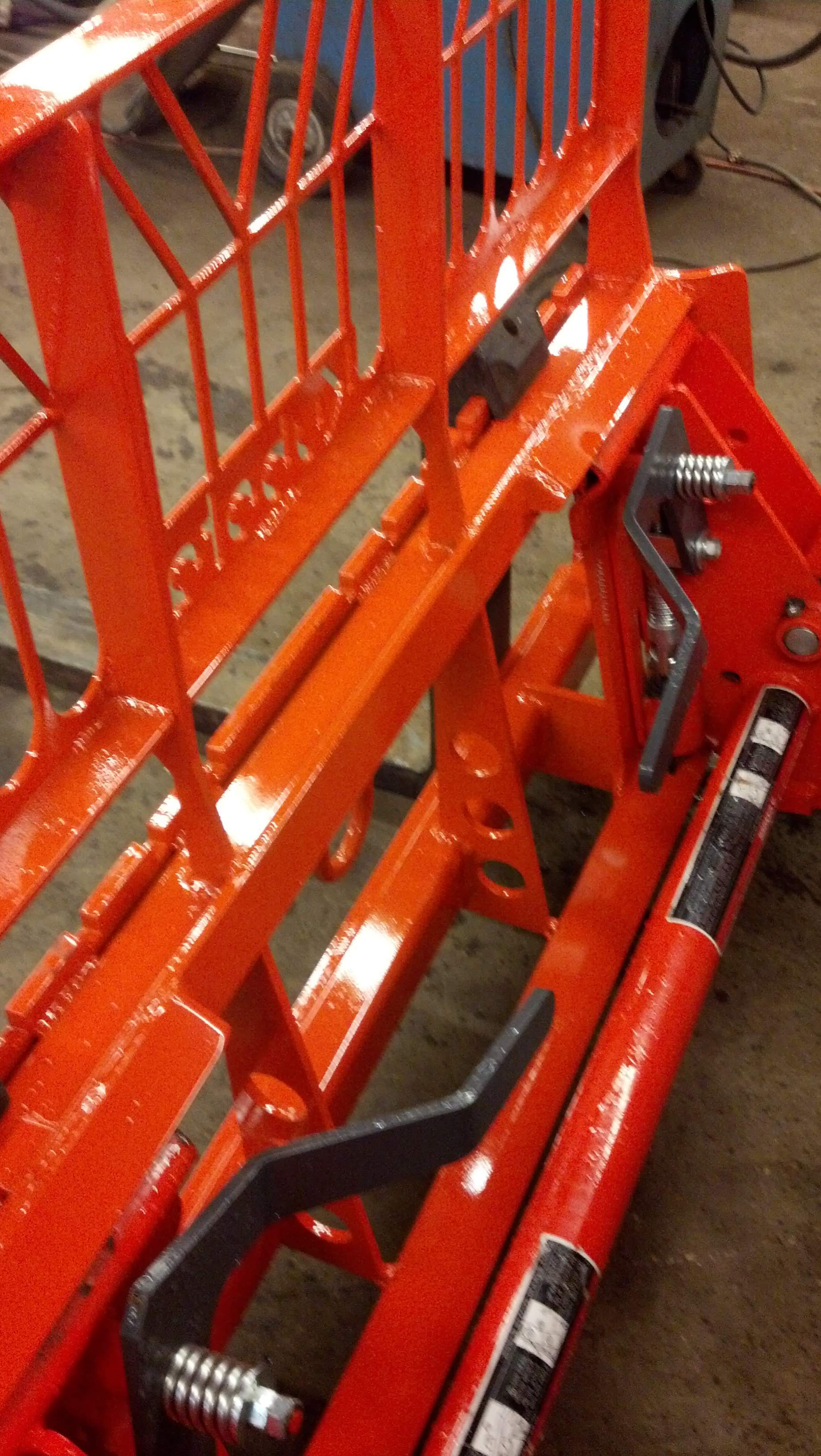

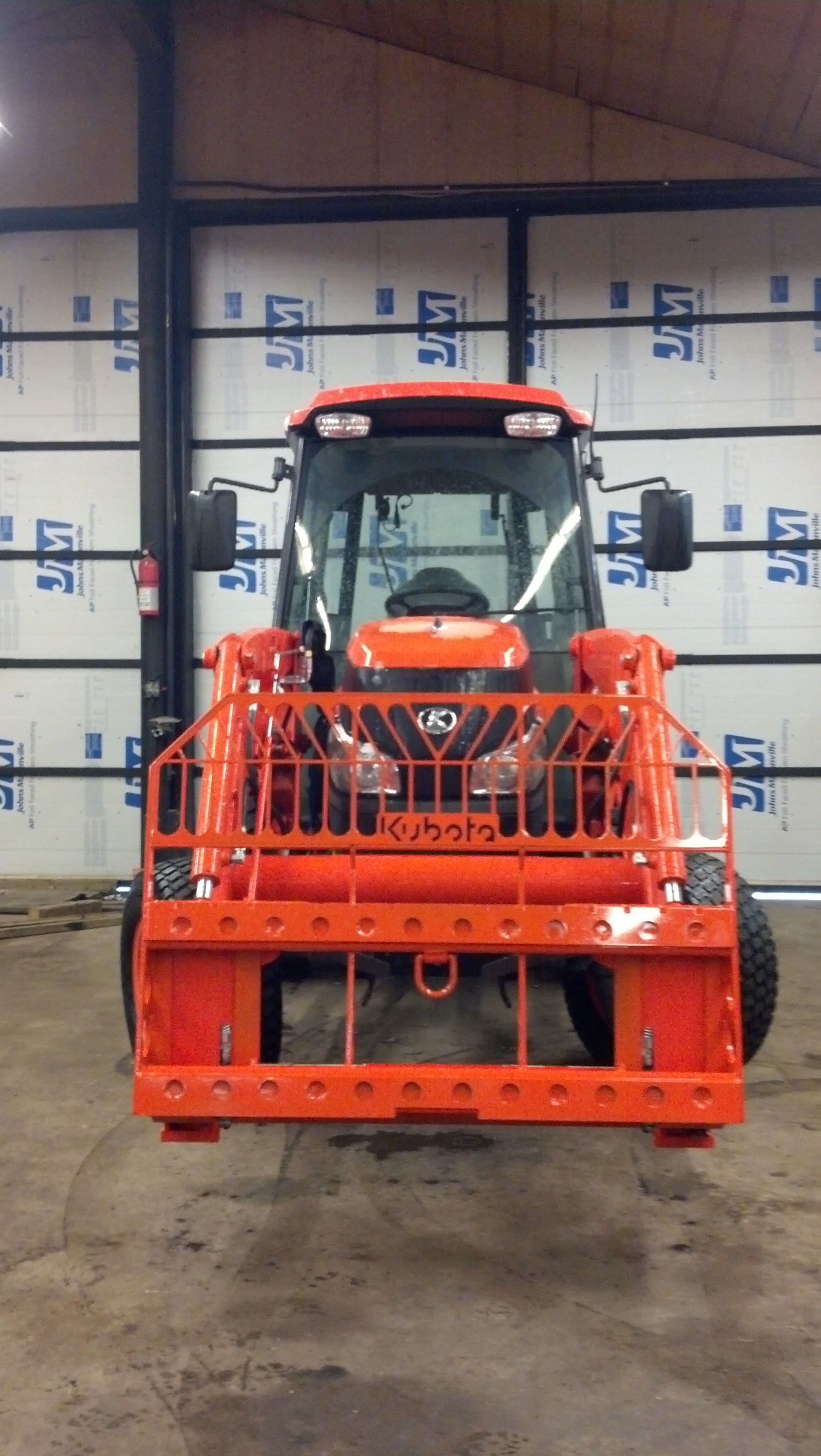

Here's a few pics after paint with Pitthane. Where the forks mount is 1/2" blanchard ground steel welded to 2"x3" 1/4" wall tube. I made the Q.A. plate out of 3/8" thanks to some dimensions I found searching the TBN forums. My friend that owns the shop bought a newer forklift and was nice enough to furnish the tines that are on my carriage. We just used them on their first job and they performed great. Picked up a 16' long 18" diameter maple log without any struggle.
