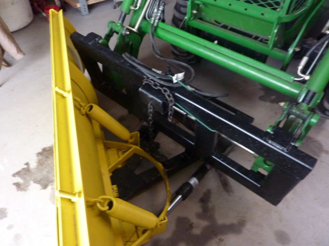

When you're planning to build a quick attach loader implement how do you decide which plate thickness to go with? They sell them anywhere from 3/16" all the way to 1/2" thick for the backing plate. Right now I'm working on an 8' truck snowplow modification using a 5/16" thick quick attach plate and plan to reinforce it but how do you all decide which thickness of plate to go with? Has anyone done a project with a thinner plate and later regretted it?

You should be fine with the 5/16 you mentioned. You'll still need a stout horizontal "member" the full width of the plate to attach the plow to. Your plow attaching points will be well within the width of the ssqa points and there is no strength there.
Notice the width difference and where the plow "land's" in relation to the loader arms, the flat plate offers little strength once off the ssqa area.
I would suggest a 3x3x1/4" sq tube minimum (full width of your plate) welded on the front side of your ssqa plate for the attachment point of the plows a frame.:thumbsup:

My bigger concern would be the top lip. Some manufacturers make them differently than others and it’s the first place I look at.
   / Quick Attach Plate Thickness, which one? #9
My bigger concern would be the top lip. Some manufacturers make them differently than others and itç—´ the first place I look at.
Bingo. That top lip needs to be supported from above, like with some gussets to the implements main structure, for example. (Sadly, I learned that the hard way.)

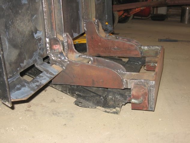

As mentioned the top lip needs to be reinforced for heavy attachments or boom poles that can exert more leverage.
Here is one:
Close up of the gussets:
And my stump bucket:
And fork frame:

As others have mentioned the upper tab is the weaker point.
On another point the easiest mounting of the blade will have it sticking out way in front of you,
there was a poster that had underslung his mount to keep it in closer that would make it work better
as long as you can get your angles the shorter the mount the easier it will be to use.
I know that my blade sticks out quite aways and it can be aggravating keeping it from pushing gravel when it's thawed.

I plan to undersling mine as well and will do a lot of reinforcement of the plate. I tend do do things overkill and it was hard for me to opt for the 5/16" plate when I could get the 1/2" one but there was a decent difference in price and also weight. The plate is grade 50 structural steel too.

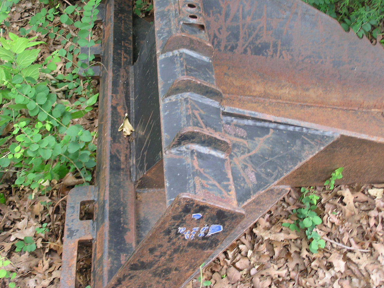

   / Quick Attach Plate Thickness, which one? #15
This is what can happen to a plate that is too wide and not reinforced. I had a heavy load on the forks and curled up to raise it off the trailer. It came up a little, stretched the top plate up over the SSQA and fell back down.
Note the straightedge:
You can see where the edge of the SSQA came out from under the top lip:

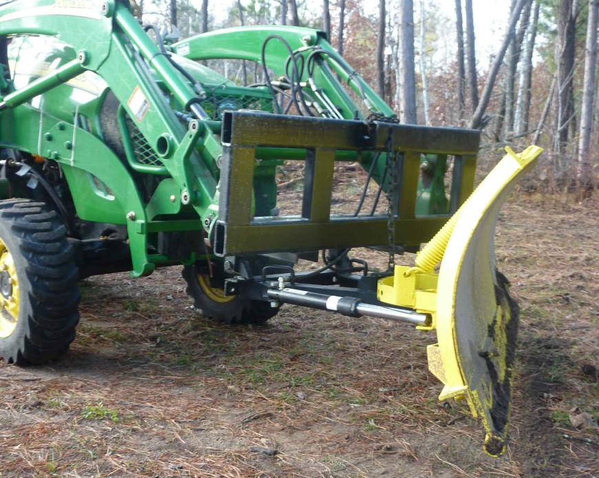

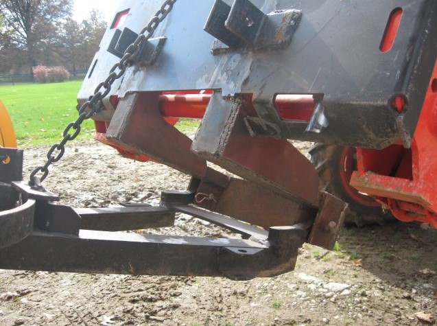

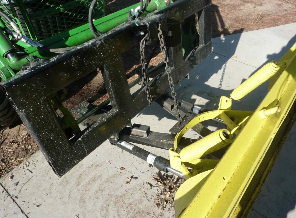

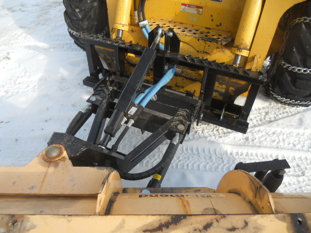

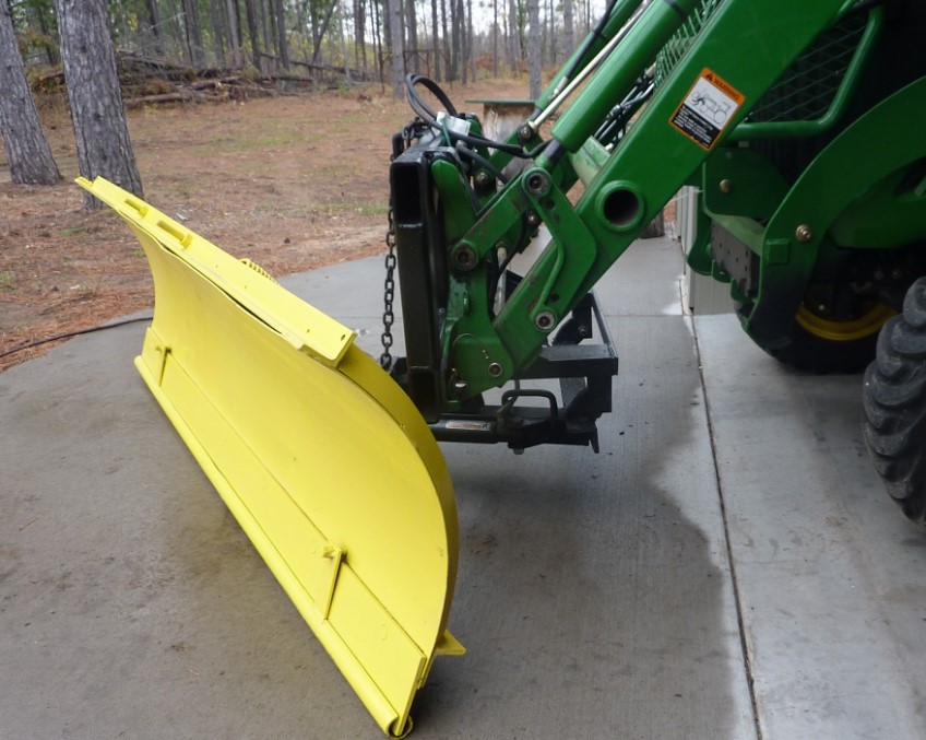

Anyone have pictures of a undersling mounted snowplow? I will be picking up a SSQA plate to mount my 7.5’ snowplow to soon. Thanks
   / Quick Attach Plate Thickness, which one? #18
Don't have any pictures but another option is to cut the A frame as short as possible but still able to use the cylinders to turn the plow.
#19
Anyone have pictures of a undersling mounted snowplow? I will be picking up a SSQA plate to mount my 7.5 snowplow to soon. Thanks

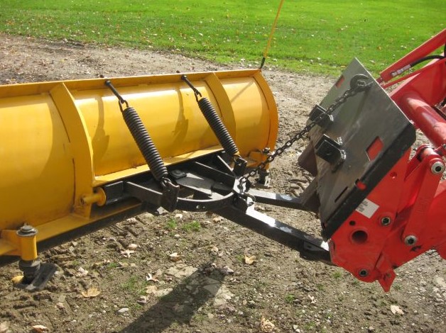

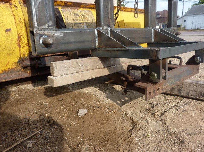

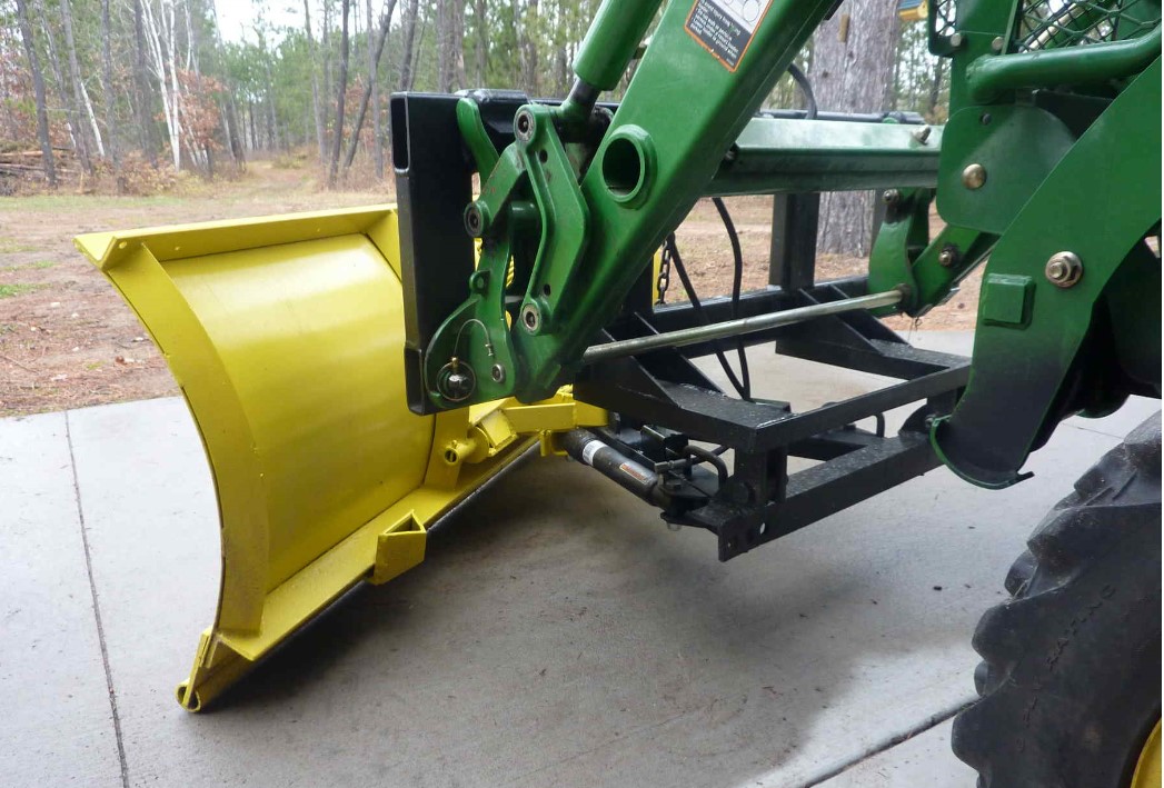

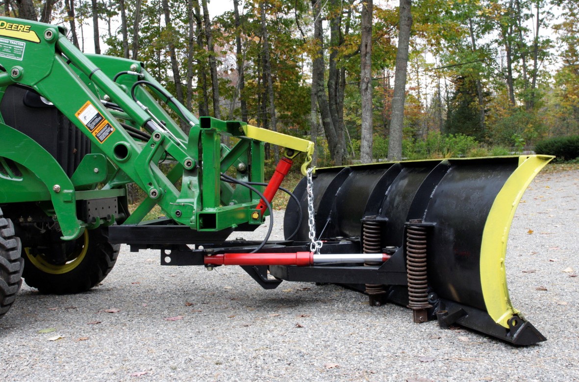

Here are some pics I've grabbed from other posts in the forum to use as my inspiration (Thank you to the owners of these plows). I'm barely getting started with my build but plan to add pictures when I'm done. The number one thing I've read about doing this is that the plow needs to be chain lifted just like it is when on a truck. If it's rigid mounted to the tractor it will be a pain to operate.
#20
If you cut the A frame the most you gain is about 6-8" but if you undersling the mount you can gain as much as the plow allows before the SSQA plate hits the back side of the plow itself or as much as the tractor allows before the back end of the plow hits something.
