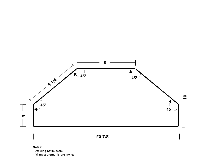

i would appreciate it very much if someone would send me the measurements for the quick attach male plate for an early 90's pt-1445. i think it is 5/8 in thick. i have the steel and plasma cutter and ready to go. thanks

I might be wrong but I don't think they started using the quick attach plate on the power tracs until about 1998. The older ones used a 3 point hitch setup.
   / quick attach plate
i believe that the quick attach hooks up as a three point hookup. check for me and see if yours hooks up on 16 in centers. what i plan to do, if i can get the measurements, is to cut out the plate and weld on the brackets for the three point hookup, my arms on the pt-1445 are 16 in centers.thanks

what i think you could do would be to order the plate that goes on the attachment from P.T. then manufacture your plate fit it. /forums/images/graemlins/smile.gifby doing this it gives you the pattern for it also.now you know everything will work together. /forums/images/graemlins/cool.gif

Would someone that knows the measurements for the Quick Attach plate for a PT-1445 please fill in the blanks
bottom length__________
straight side __________
angle cut in inches ________
top ________
thanks
j.j.

See attached Pic for dimensions...
