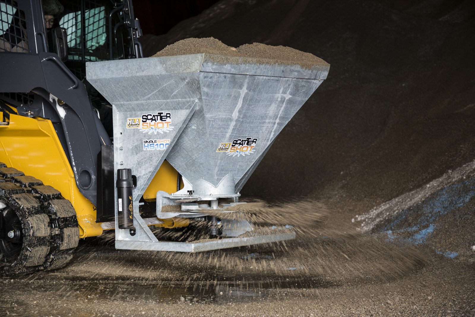

Check out the scatter shot from HLA. It mounts to a SS Q/A and runs off hydraulics. Once mounted you scoop the material like a bucket, use the hydros to spread, and can dump the extra material when finished. I thought they were a great idea....challenge is to have enough machine to use it, not just run the hydraulics. I have a Kubota L4240 and my dealer said it could not handle the unit on the FEL. I was told they are ideal for skid steer or larger tractors. I asked about a Kubota M7060 and was told it would be good on that sized tractor. There are other brands out there too.
