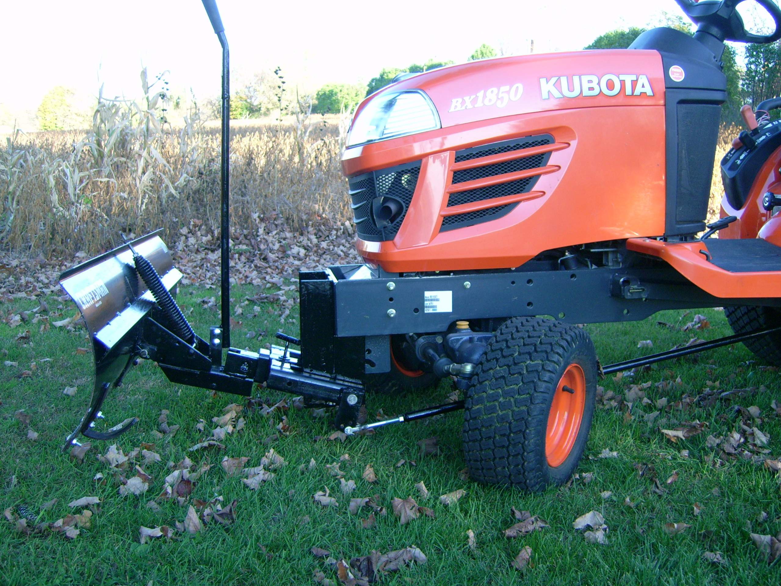

Hi Guys. I am a new member and relatively new BX owner.
I made this front blade attachment for my BX1850 and it uses the rear 3pt hitch to raise the front blade. I use the mmm lever control to raise and lower the blade and I can use the deck height setting to even maintain the same blade height if I wish to not drag it. I have not tested it on snow as yet but in time I will find out how well it works.
