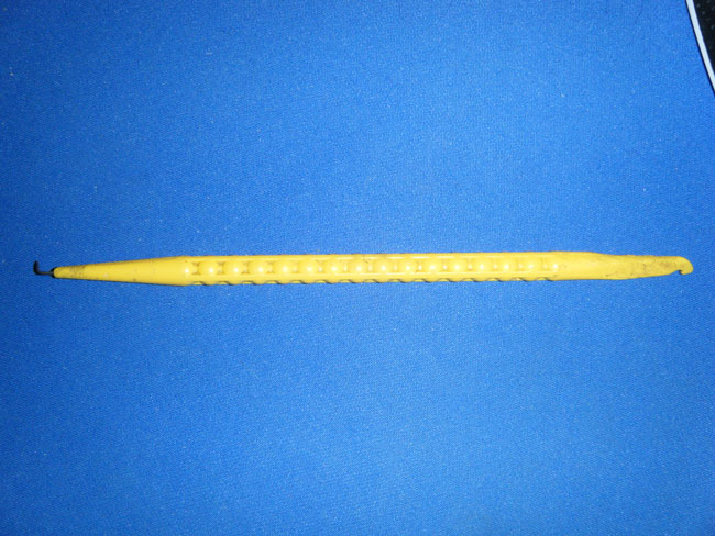

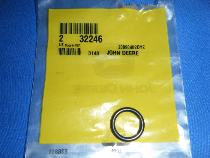

Yes when I thought as you that maybe I had a bad coupler the John Deere dealer suggested I first try the "O" ring. The JD parts guy new immediately what size. I just took a quick look and the old package (them come in a package of two)
is labeled 2 32246
20090402dy2
John Deere
So I am not quite sure which is the actual part number. I think the only "O" ring in in the female tractor end. When you look inside the connector you will see the black "O" ring sitting inside a machined groove. I used a spudger (small plastic handle with a right angle metal hook on the end) to get under the "O" ring and pull it out then gently slide the new into the groove.
I hope that's your trouble as it's a cheap fix.
