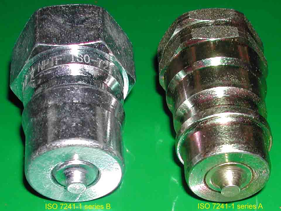

So I went to hook up my mini hoe, when I went to connect the hydraulics, one of the fittings was bent. I must have pinched it. I looked up quick connect fittings and I couldn't figure out what type they are. The two most popular are ISO A and ISO B. I searched the forum, but couldn't find the info.....
Anyways, if someone could let me know, I will order a new one. The lines are 1/4". I would also like to get a bunch of dust caps, to help keep the fittings clean.

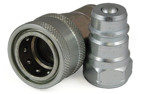

I believe the QD's on mine were Faster NS series. I just took one of mine to the hyd store, and looked through the bins until I found one that would match. If you have to, change brands to what your local supplier has. I could look on mine and get the number, but you may have different manufacture for yours. I had a chart for different QD's that interchange, just where, I don't know.
Probably ISO 5675
Hydraulic Quick Disconnects > Discount Hydraulic Hose.com
ISO 5675 Agricultural Hydraulic Quick Disconnects
They also have the dust caps.
http://www.hfifluidpowerproducts.com/Pages/High-Pressure-Quick-Coupler-Cross-Reference.html
If you look in this chart, find your number on your QD, and cross it to what ever is in your area.
Everyone should bookmark this link for future reference.

All my Deere stuff uses ISO-B, while Kioti uses ISO-A. I buy all my
QDs from DiscountHydHose. Since you have JD equipment, have you
compared to the QDs on those units? I do not know if JD uses ISO-B
consistently, however.
One limitation of DHH is their QDs connect to NPT fittings and hoses,
while my JD stuff likes ORFS. You may have to buy adapters if you order
from them.
