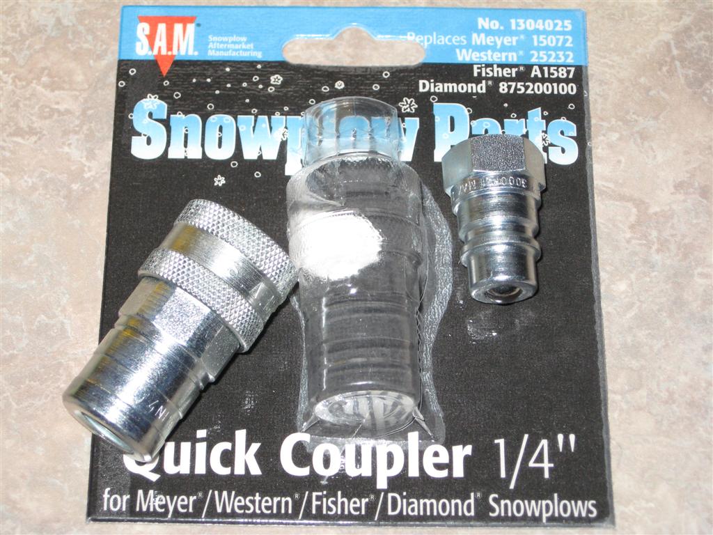

I need some 1/4" quick connects that have a retaining groove for bulkhead mounting. I'm looking for ISO 5675 (ag) type. I need to order a bunch of stuff from discount Hydraulic hose and I'm not sure there quick connects have the retaining groove. Does anyone know where I can buy this type cheap?

If they can be the ball type, I just installed 4 of them on my garden tractor. Tractor Supply and O'Reilly Auto Parts have them in their snow-plow section.
-Neil

We discussed this at the end of THIS thread. A couple of us think that bulkhead connectors are stronger and easier because they do not require a precise diameter hole or thickness of material.
   / Quick connect with a retaining groove #4
Our AG couplers (Pioneer 4000 Series Interchange) do have a groove on the female coupler that may be the retaining groove you are asking about. The male coupler does not have a groove.
As kennyd said, though, a bulkhead coupler may be better solution.
This one should work with your quick disconnects.
Male Pipe (NPTF) x SAE 37ー Flare (JIC) Bulkhead
