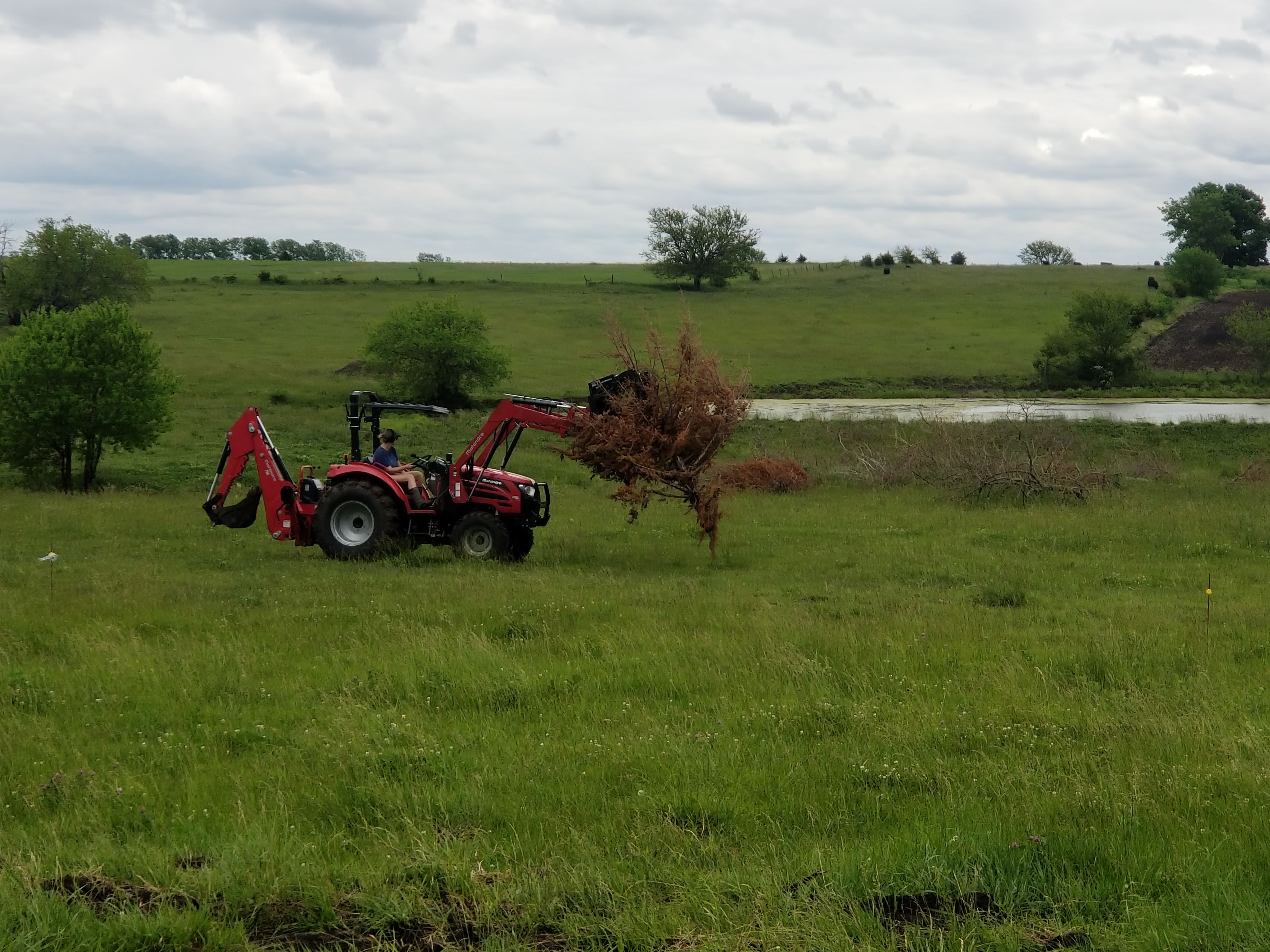

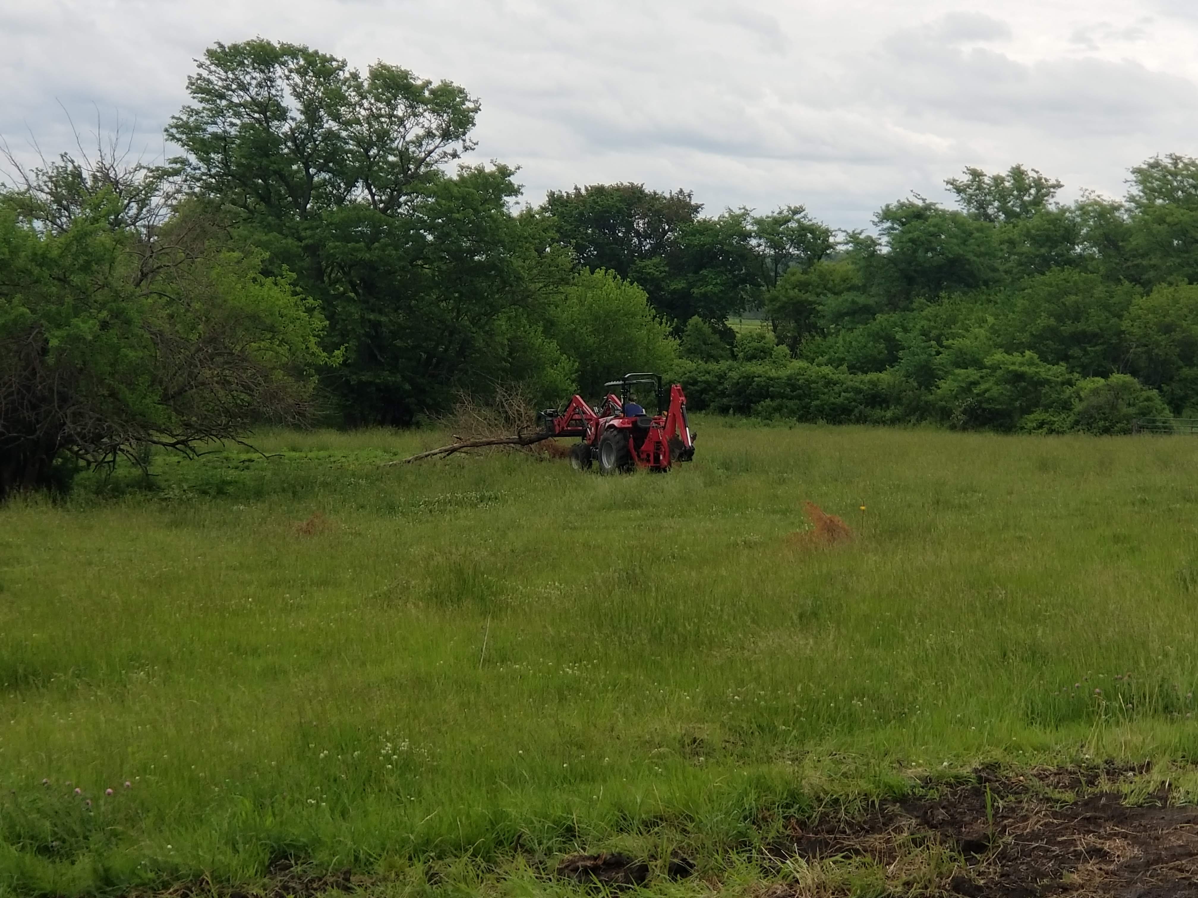

Here are a couple pics of my wife using the tractor and the grapple for the first time to move around a bunch of brush I cut. I was inside finishing the electrical on the barn so she decided to try driving the tractor and getting the brush cleared. I had to tell her to keep the loader arms down when possible and lower the center of gravity, but she got a lot done and is much more comfortable on the tractor now!
