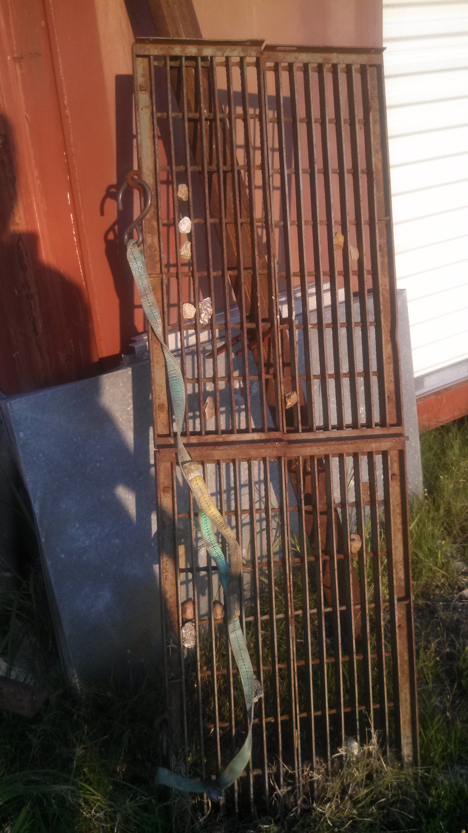

The best ones I have made were made with steel catwalk grating welded together.
They are basicly 1x1/4 serrated flat strap on the walking surface that is against the dirt for dragging.
This one is one I put together to pull behind a 4 wheeler using a forklift battery strap via one chain link cut in half and welded to the front (take strap off when no in use). I have saved a bunch of them over the years because new straps come with each battery and they have an extra loop in the center to keep it from shifting from side to side, they also make a perfect strap for gambrels as you just run the large loop through flat strap and there is still enough loop to hook through the legs and they store in almost no space.
471430d1465518745-quick-dirty-drag-img_20160609_192732_195-jpg
We have used that one for more than a decade and does a great job for what it is. 5' wide and 20" long.
They scrape up and hold/bust clods until there is a place for them to fall out but as you can see rocks can get stuck I between them, doesn't seem to hurt function much though. We built it for leveling trails but I have used it here at home to maintain crushed asphalt.
I recently put another one together for the farm with even more sections that works even better but is a bit more to drag around.
