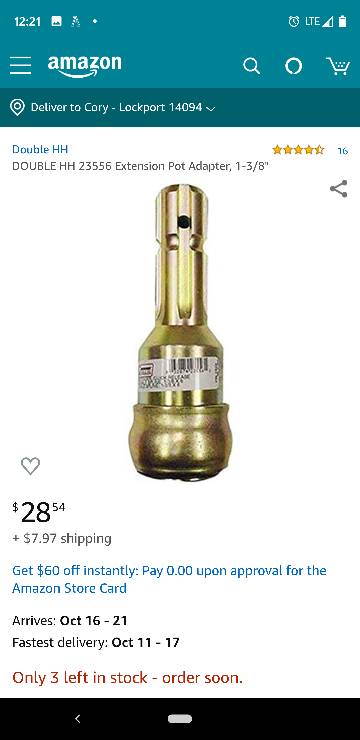

You can buy a PTO extender so as to not have to remove your QH. I use one with my HF QH and JD Brush Hog and KK Tiller. Works flawlessly and is cheaper than a new shaft. Screenshot_20191009-122112.jpg

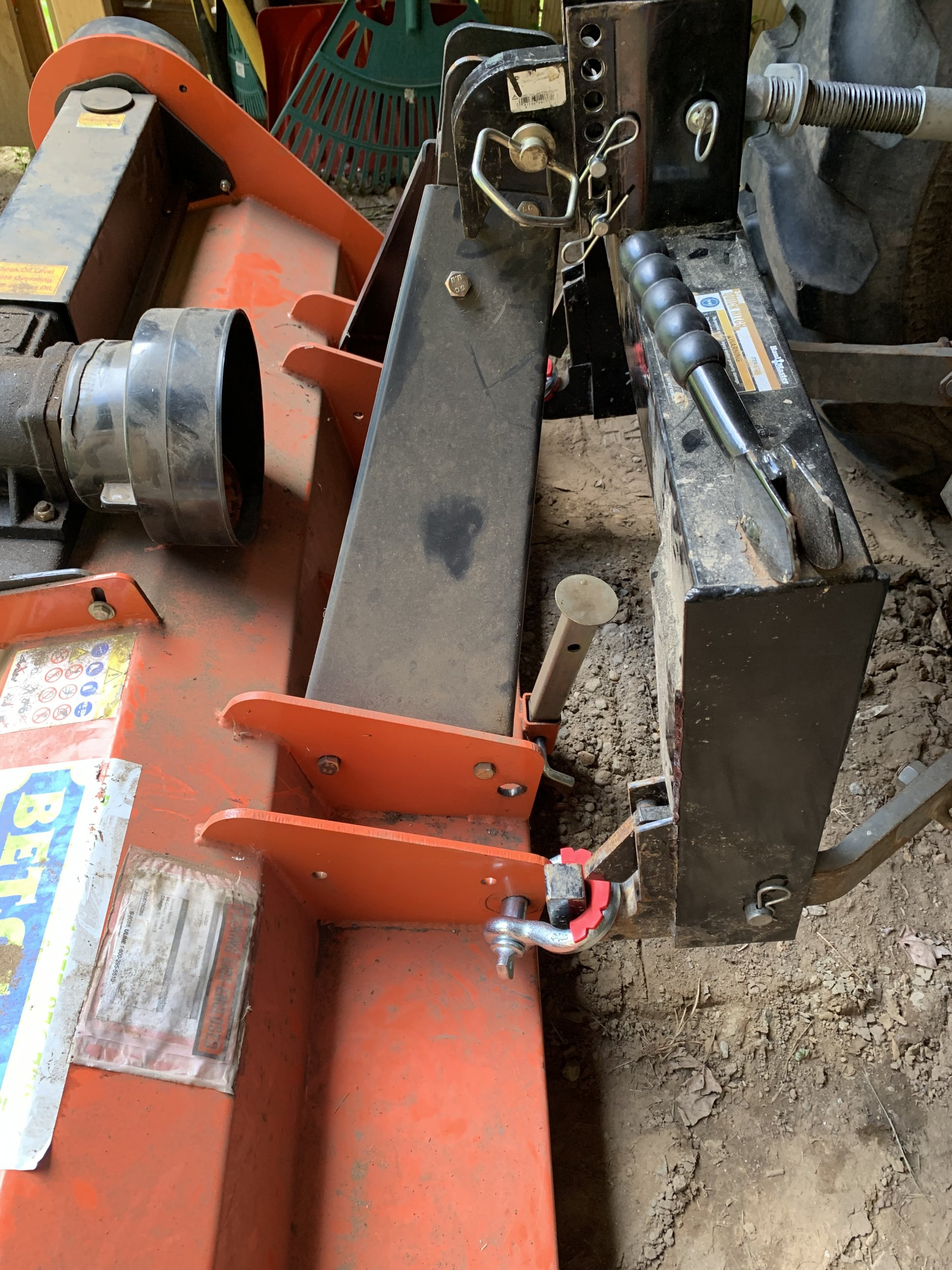

I know this is an old post but I figured out a cheap, easy, no machining way to get the quick hitch to work. I have a standard duty 135 Betsco flail and my quick hitch lined up with welded uprights just right. I ended up getting a couple 3/4” shackle anchor from Home Depot for about $11 each. Tractor supply has them with pins and calls them farm clevis, more expensive and they didn’t have them in stock. Put them through the holes drilled that the pins go through. If you drill out the threads on the one side of the shackle you can use the pins that came with the mower, I didn’t, or get smaller diameter pins, probably a good idea with all the vibrations. I tried drilling and I needed something more powerful. There is a little side to side movement so it will probably work with other mowers. When you go to hook up, flip the shackles up, back up your tractor, flop them down. With the top hook, turn it upside down, put it on the mowers top pin, and it will probably be on the lowest setting. If you don’t do this, your pto shaft will probably hit the top of your quick hitch before you are all the way lowered. Mine happens to be on the outside, I could unbolt it all to side it over, I don’t see the need. I had to have the top link extended fairly far out to prevent the mower from digging in the front. I needed a pto extender for a few inches.
So far no issues, but it is easy to do, fast, and I’m not mowing golf courses, just around my house, pond and fruit trees. I know in the picture there is no pto shaft, but you probably know what it looks like. I drive a 1993 Kubota L2650.
