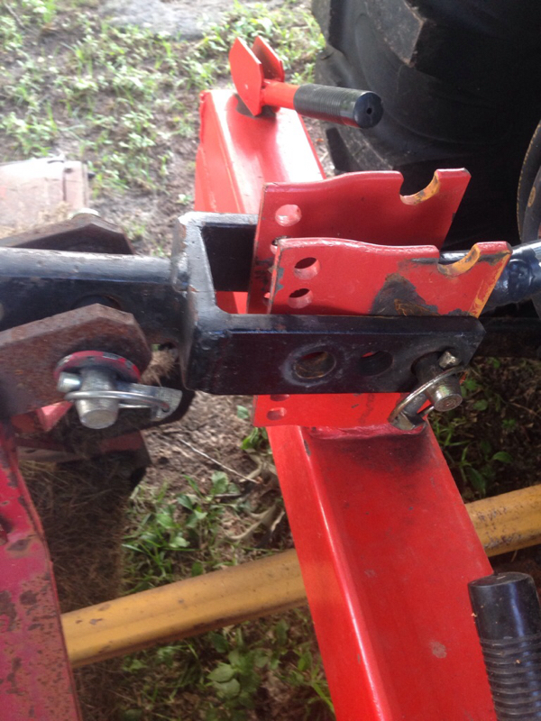

   / Quick hitch, now cutter shaft too short #7
200 - 250 for a complete new shaft and clutch assembly would be the way to go if you don't have the means to change the tubes yourself, by the time you purchase new tubes and have a shop do the work you'll be at that price or more. As for the top hook, I use a adapter instead of the hook.
   / Quick hitch, now cutter shaft too short #8
DOH! That is the same adapter I bought from Agri Supply for 10 bucks and I was too stupid to figure out how to install it. :duh: Thanks for the pic!:thumbsup:
   / Quick hitch, now cutter shaft too short #9
Yep I made this one but it's the same as the one they sell, I have the top hook but it's but up in the shop and I never use it.
