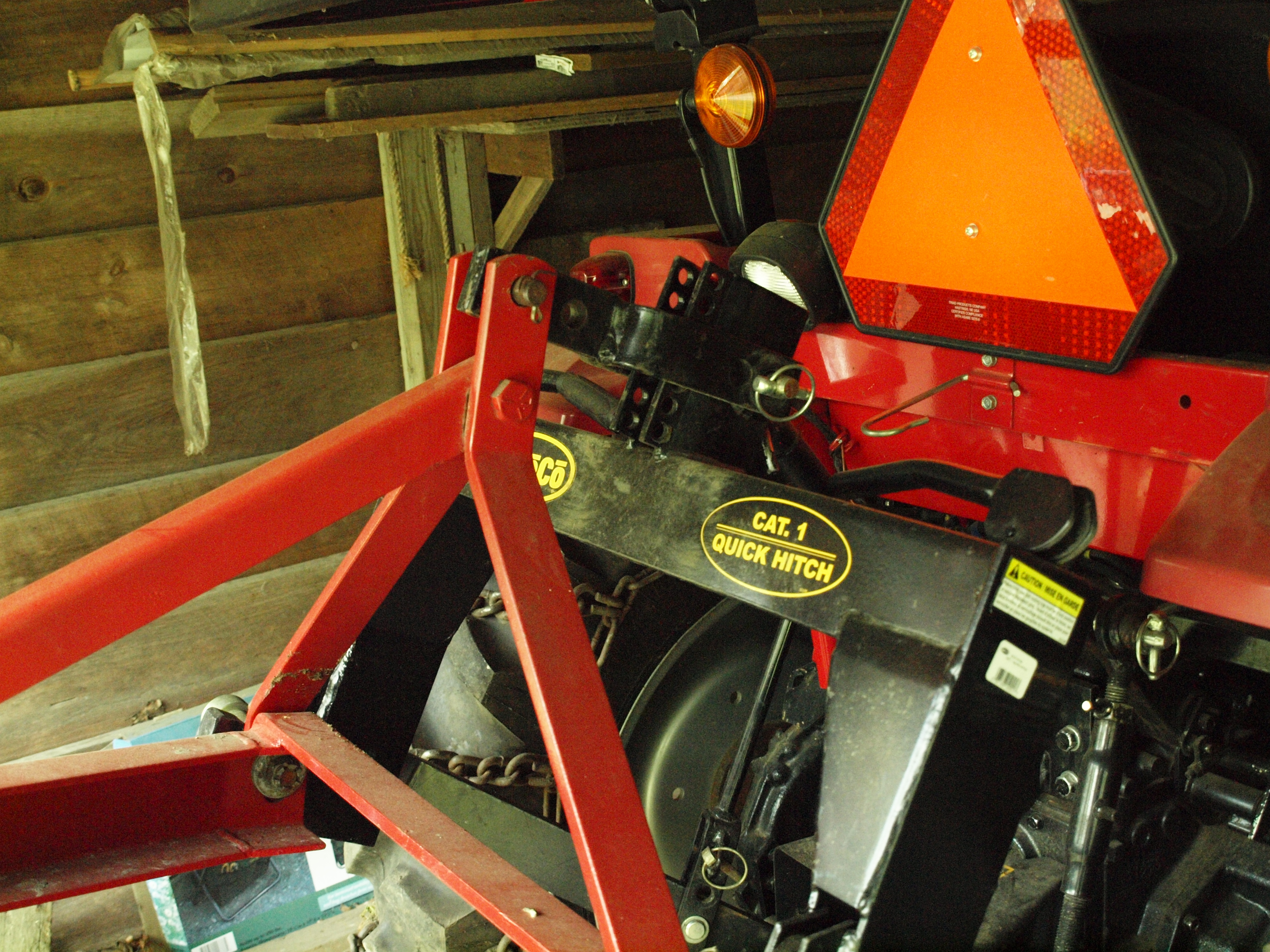

   / Quick hitch question #2
Here is a picture on one not in use. Notice the top hook has already been removed. In use it would be flipped over and the implement top connector connected to it.
So in order to use this forking device, you have to remove the top hook of the quick hitch, flip this thing over and then insert the "handle" of the fork into the third link hookup point of the implement and use a traditional pin in it? I have a 3 point drag made by the Burch Plow Works that has a bolt holding the A-frame together only about 2" below the third link pin hole. So the device is primarily used when attempting to use the quick hitch on implements that don't have sufficient clearance between structural members for the top hook to slide under or between, correct?
I'd still like to see a picture of one being used to attach an implement to the quick hitch if somebody can snap one.

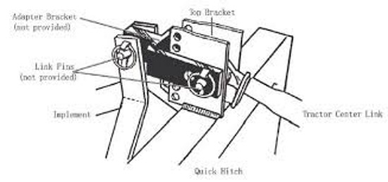

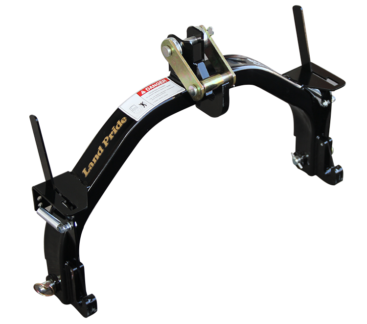

   / Quick hitch question #4
Don't have one, so no picture, but here is one slightly different that might help you visualize how it works:
And these:

The purpose of the link is not to make it easier to hook up. It is to make it POSSIBLE to hook up implements which can't use the top hook for some reason.

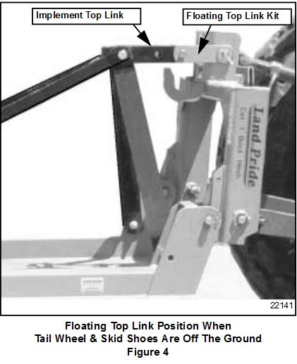

If you want your implement such as a brush hog to lift over obstacles or follow ground contour you need to use the floating link instead of the hook. Hired hand didn't use it one day (in a hurry and used the top hook) promptly bent the top link when he hit a big rock buried in the grass.

Thanks for all the replies and pictures/diagrams. I now understand that the adapter is used on implements where the upper hook won't fit as in 'arrows' picture of the back blade, and the floating top link is used on implements that need to flex during use such as a brush cutter as shown in Xfaxmans diagrams.
