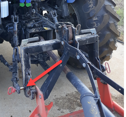

I’ve got an Orange MX 5400, and was looking for a Quick Hitch.
I was looking at the SpeeCo Category 1 E-Hitch S14116000. This model has proprietary Cat-1 hook ups, so you don’t need bushings for every implement. The description reads that it is for a maximum 50hp tractor. The HP for the MX is 55ish HP. Am I OK getting this QH?

Your MX 5400 has 46.5 PTO HP...
I think the Quick Hitch (Category 1) will work fine, IF you have category 1 implements

I have a Land Pride QH15 on both my tractors. I had to use bushings to get the Cat 1 hitch tied to my Cat 2 WM75, no big deal. I have bushings on all implements to get a tight fit in the QH, so there is not any play. Bushings are cheap at TSC, it is a one-time purchase, they stay on the implement. Depending on the implement I also have to adjust the top hook. Easier to do that than try to adapt every implement to the same configuration.

Is your tractor CAT I or CAT II?
Well, when I hook up my bush hog, box blade and disc harrow, I have to put the little sleeves in the 3pt holes. If that is what your meaning. Again, I’m still learning.

Sounds like you have a CAT II hitch on your tractor and you are attaching CAT I implements. So the hitch you asked about will be fine for CAT I implements but it won't attach to CAT II stuff. If it was a QH with bushings it could be used on both of them from a pin standpoint. However, a CAT II QH is not going to be anywhere close to the same measurements as a CAT I.

I have to put bushings on the implement pins here to get a tight fit in the QH hooks.

I had to put long bushings here to get the CAT 1 QH15 to mate up with the CAT 2 3PT on the WM75. It still has some play in it that I need to work on. All of my implements are CAT 1 and work fine on the WM75.
